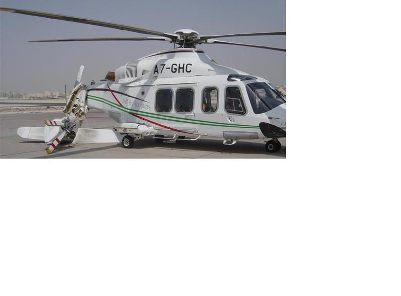

Had it confirmed to me this morning that a Gulf Helicopters AW139 lost its tailboom while taxiing for takeoff yesterday. No more news to report at this time. I know from experience with the 139 that there are lots of problems with delamination on the tailboom close to the attach points. We have changed 2 tailbooms in the past year on the SAR contract machines, and at the main hangar our fleet of 139s have had numerous more. Be interesting to see what Agusta has to say about this!

Here's a pic of the machine!
Posts: 4614
Re: AgustaWestland AW139 shed its tailboom in Doha
Post by sky's the limit »
:shock:
Jesus. Really? All on it's own? Wow.
That's not a confidence inspiring photograph. I bet the crew is out buying lottery tickets, a minutes later and that would have been catastrophic.
