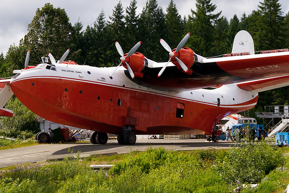

Daryl
crazyaviator
Posts: 671
Joined: Sun Oct 21, 2007 7:52 pm
Location: Ontario
Re: Compans swing on float plane
Post by crazyaviator »
Yes, once the guys line you up to North with the beaching gear on, and you bring the power up to check the compass stability, you may soon find the rose behind you in your peripheral vision, and the taxi way, and the runway, and the perimeter fence, and Airport road,,,,,,,,,,
Zaibatsu
Posts: 602
Post by Zaibatsu »
crazyaviator wrote:Yes, once the guys line you up to North with the beaching gear on, and you bring the power up to check the compass stability, you may soon find the rose behind you in your peripheral vision, and the taxi way, and the runway, and the perimeter fence, and Airport road,,,,,,,,,,
Uhh.... okay. :smt017
crazyaviator
Posts: 671
Location: Ontario
Some folks call that vehicle in the pic a dolly. Some beaching gear involve a wheel that is stuck into a round hole in the floats for "beaching" only ( no brakes) ,,,,, I was trying my luck at a joke ! :roll:
crazyaviator
Posts: 671
Location: Ontario
This is beaching gear ,,,likely has no brakes!!
