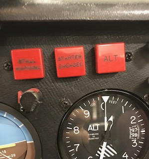

A stuck starter contactor is a serious problem in any piston engine - so much so, that in the UK, it has been a requirement to have a "starter engaged" warning light, to indicate such a failure to the pilot. Fortunately in the Lycoming, and small Continental designs, there is still an over running clutch in the starter to engine drive line, so the starter motor continuing to be energized will not result in its being driven by the engine, the over running clutch will slip as intended first. (Otherwise, the engine, when it first kicks to life, could not accelerate faster than the starter is turning it). So, energized stater is not good, and will ruin that over running clutch.
Much more serious, is this condition in any larger Continental engine with a "starter adapter": O-300D, IO-360, all 470/520/550. You know you have a starter adapter if the starter motor axis is at right angles to the engine centerline. In the case a stuck starter contactor in this arrangement, the clutch inside the starter adapter, which is a cunningly designed coil spring (about like a super dense slinky), will become red hot, distort all over within the housing, and ultimately fill the whole engine with steel bits via the common engine oil. The adapter will be scrap, and expensive repairs required. The problem is that the pilot probably will be unaware, and it will only be at the next start attempt that this damage will be found. Preventative starter contactor replacements are low cost by comparison. The are good quality, and low quality contactors, so use the specified high quality ones. Canadian Aero Manufacturing in Orillia sells starter engaged light warning kits.

Ah the Brits!PilotDAR wrote:A stuck starter contactor is a serious problem in any piston engine - so much so, that in the UK, it has been a requirement to have a "starter engaged" warning light, to indicate such a failure to the pilot. Fortunately in the Lycoming, and small Continental designs, there is still an over running clutch in the starter to engine drive line, so the starter motor continuing to be energized will not result in its being driven by the engine, the over running clutch will slip as intended first. (Otherwise, the engine, when it first kicks to life, could not accelerate faster than the starter is turning it). So, energized stater is not good, and will ruin that over running clutch.
- IMG_2856 1.jpg (64.44 KiB) Viewed 1323 times
