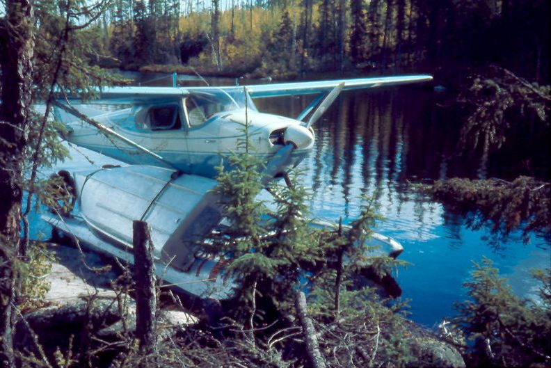

That's a 14 foot boat on a 1954 C180. Many times I would have myself, the motor and a couple of hundred pounds of gear inside.
CF-IQG 1977.jpg (104.85 KiB) Viewed 6808 times
