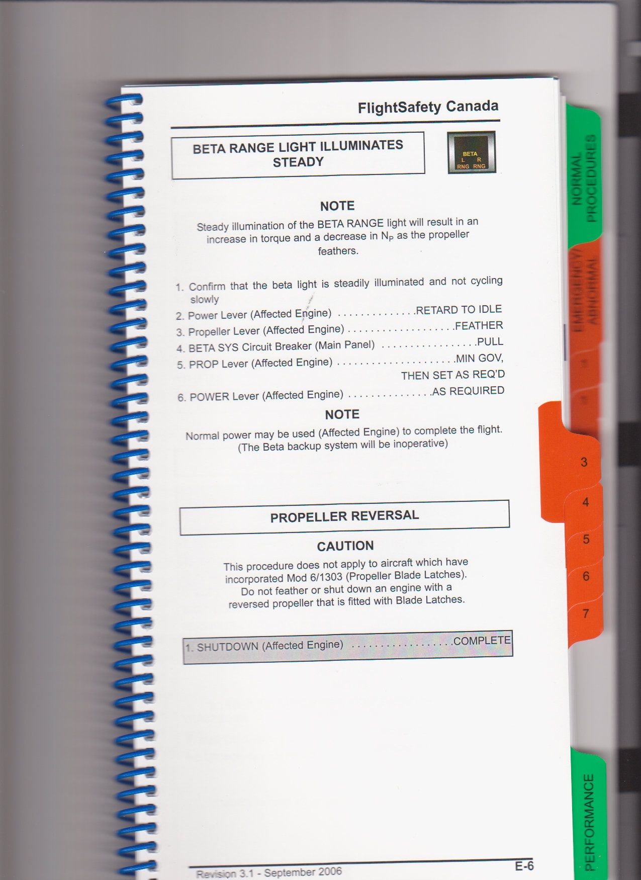

NWONT wrote: Sun Feb 18, 2018 7:52 am Flight-Safety Checklist
Flight-Safety checklist.jpg (348.77 KiB) Viewed 3231 times

Pull the breaker....twist the grip momentarily for a steady beta light....both do the same thing.....disable the beta-backup system.....right?

Gyvair. If you are flying single pilot.....at night...and a steady beta light come on then the valve has closed, shutting off oil flow. The beta back-up system has malfunctioned so you want to disable it. If you need a second or two to find the breaker, you can twist the grip, which will disable it, all is good now...and locate the breaker and pull it. Or you can power back, feather the prop, then find it, pull it, then unfeather and re-adjust your engine. If you have mistaken a flashing light for a steady light...then twist the grip.....well.. shit's gonna get real!!! The first thing you will notice is your props slowly go out of sync....you have time to observe and make the proper actions. I had this discussion at Flight-safety.....and they don't agree with my method and I have used it when I had a steady light and it works fine. Paneuro says Flight-Safety has never taught the feathered engine method. Well it's right in their check list....and NO!! I don't want an extended argument with Paneuro, he is a Twin Otter Guru and I say that respectfully.

Paneuro, you chopped up my post, fitted the words together to suit your purposed and totally misrepresented what I said. Don't do that again!!....or I'm going to remove that "respectfully" comment I made!!!

I'm quite surprised to see that the FlightSafety checklist image posted at the top of this page, which has a revision date of 2006 (and therefore is most likely not the current version), advises the pilot to feather the propeller.
The most recent version of the AFM/POH that I have a copy of (I retired in 2013, this revision was current then) does not mention feathering the propeller in the event of a steady beta light. No previous version of the AFM ever mentioned feathering the propeller in the event of a steady beta light. I do not know if this procedure has been revised since I retired - perhaps someone with a current copy of the AFM could check and let us know.
Below is an image of the AFM procedure, at revision 53.
Steady Beta Light AFM Rev 53.jpg (181.42 KiB) Viewed 2711 times

Check what you posted!! You said FS had NEVER used this procedure!!! This checklist is dated 2010. That was pretty arrogant of you. You also spliced my words from two posts to come up with bullshit I never said.....NOT NICE!!! I recall a few years back you got brought down a peg or two about ferrying Twin Otters. Don't let it bend you out of shape......I think I know everything too!!!

I just noticed...the Viking check list is dated 2010 also!!! Like I said, Flight-safety trains with lawyers in mind. Twin Otters can do a helluva lot more than Flight-safety says they can!!!

NWONT wrote: Sun Feb 18, 2018 9:38 pmThis checklist is dated 2010.
Uh, no, the date I see at the bottom of the photo of the checklist you posted is September 2006.
NWONT wrote: Sun Feb 18, 2018 9:41 pmI just noticed...the Viking check list is dated 2010 also!!!
Yup, that's correct.
Ah, it is true! However, Flight Safety, as well as every other professional training organization I know of, trains the safe and legally complaint operation of aircraft. That's what their clients expect of them, 'cause that's what will keep the flight safe,, and the lawyers away. Every plane can do more than it says in the limitation section, 'doesn't mean we go and do it!
If there is a genuine operational need for a limitation expansion, you can apply for an STC, or a flight permit. Maybe TC will agree with you (overweight ferry is an example). In the mean time, appreciate that the aircraft was certified with limitations to give the average well trained pilot room to breath, fly the plane properly, and get home safely at the end of the day! It is surprising and disappointing that a few pilots seem to place so little value in the flight manual, and its limitations. One of the things I've learned during flight testing is that once you're outside limitations, things can become exponentially different with only a small exceedance - things going bad is not always linear. And then you add a system failure or other emergency on top of what you already should not be doing, and there's no getting back.

The date on the front of the checklist says, Revision 3.2 November 2010....so obviously that page hasn't been amended to that point. Going for a margarita so won't be in this discussion for a week
