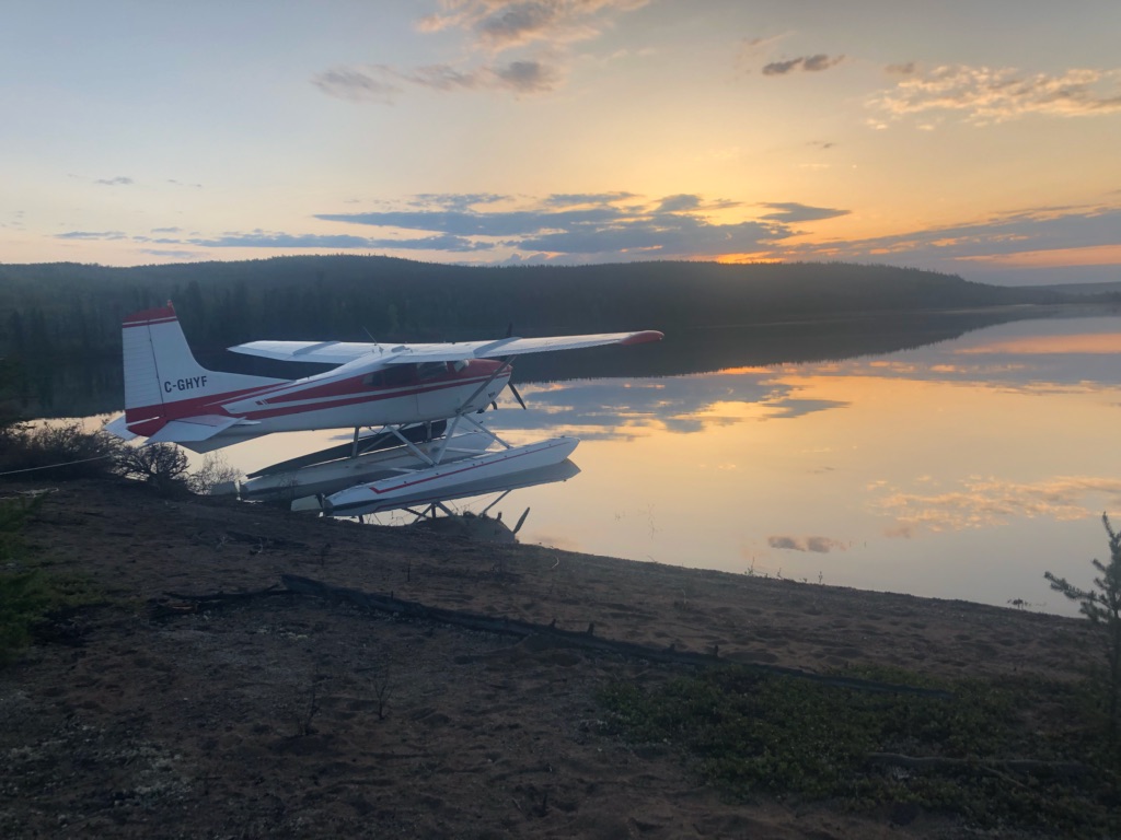

Take a picture of it folded up if you can, I’m intrigued

Yes it will be fine.

I've carried these before and they are almost undetectable with respect to aircraft performance.
Almost! - Firstly, make sure you mount it with the open side (The top of the boat.) facing down. If you don't, it fills up with water when you take off. Secondly, the older aluminum ones work well; the newer, plastic ones, tend to "fold over" if they are rigged too far ahead of the strut into the air flow. I have heard of people having it fold back as soon as there was any yaw and that tends to "pull" to that side once it is bent. Either make sure it is rigged far enough back or put a piece of 2X4 inside it to give it support.

Yes.... as with any external load!!
Eater

Unfolded
Unfolded

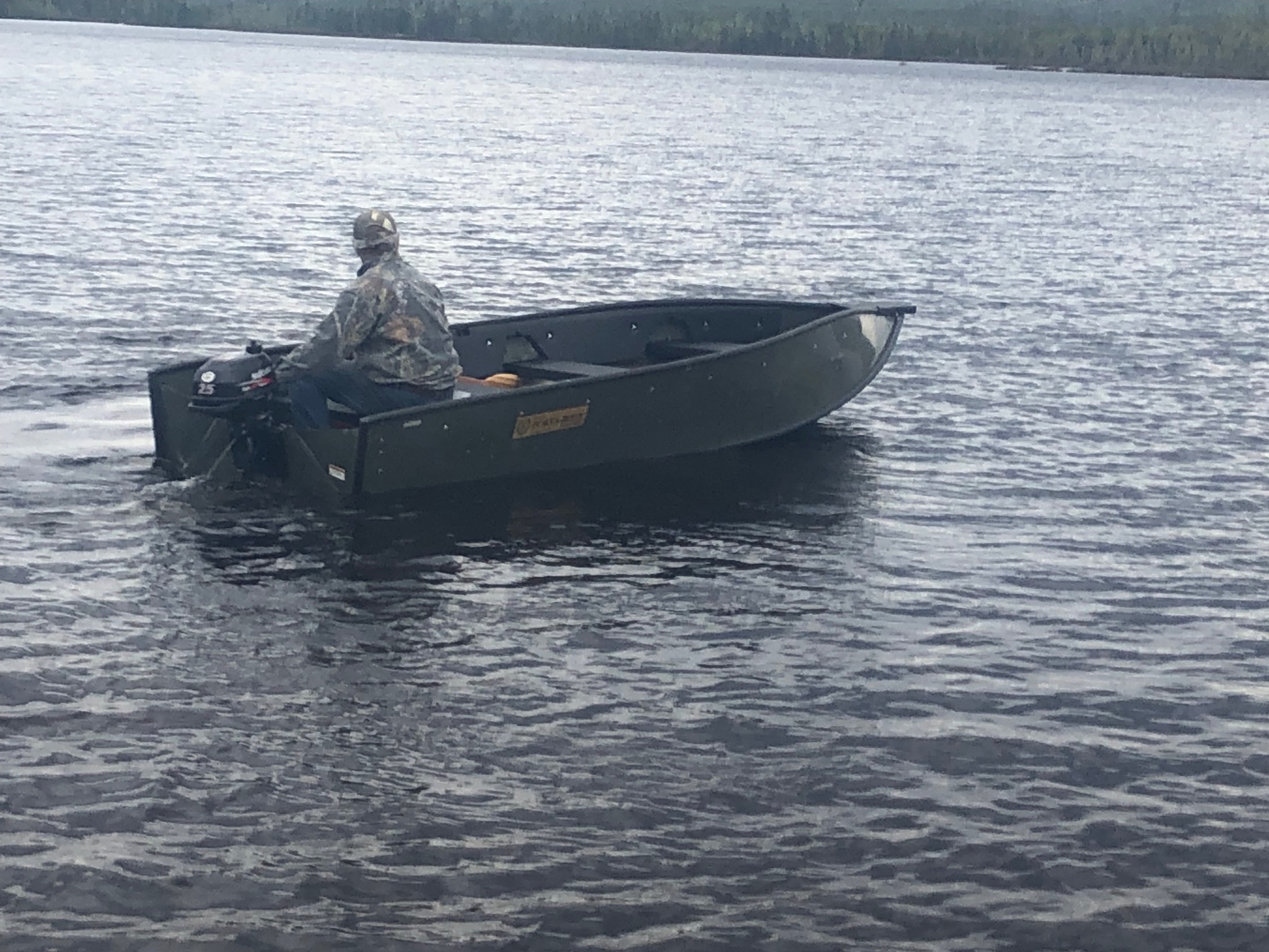

I have used a porta bote a few times. If you can take a few pieces of plywood along to use on the floor. I always felt like I was going to fall through. I carried them in my Beaver also. You will be amazed at the number of bolts used to hold one together. I was finding them in pockets next day.
