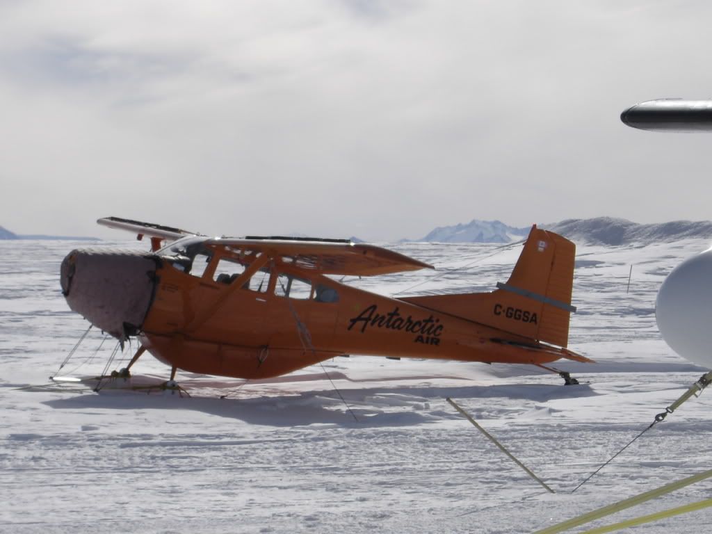

Pool noodles work! There was a 185 in the Antarctic that used them in conjunction with buried tie downs for years and never had a problem.
