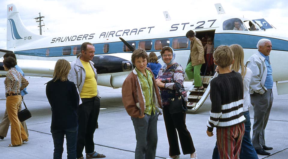

- ST-27 Andre Belanger pic.jpg (77.93 KiB) Viewed 4118 times

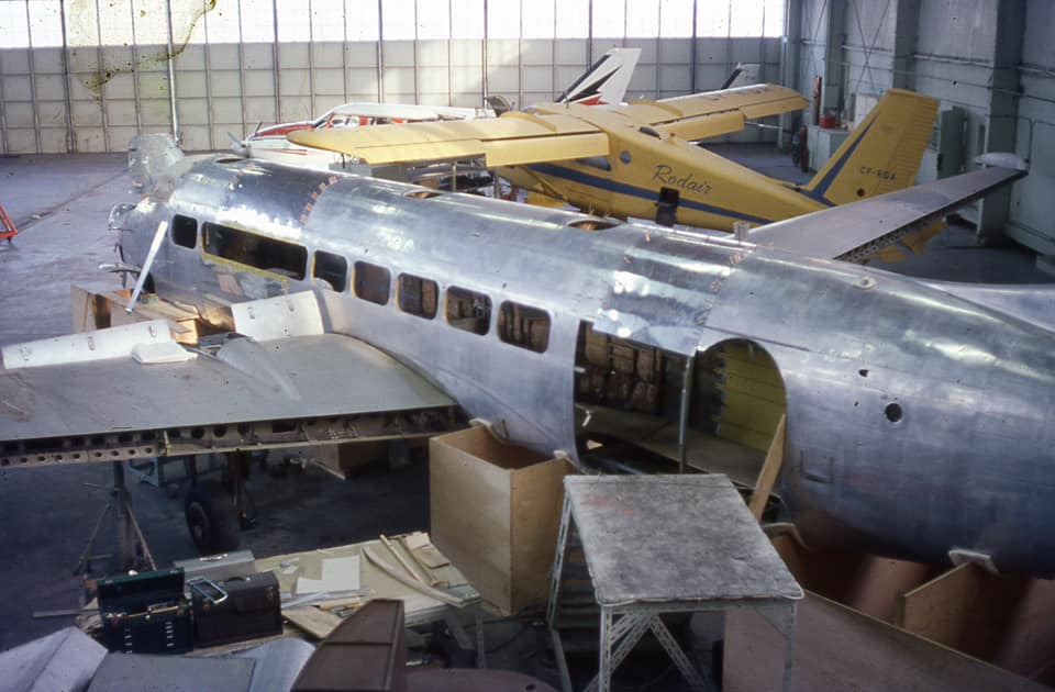

- Saunders ST-27 fuselage mod Andre Belanger pic 2.jpg (61.14 KiB) Viewed 4118 times

recognize anyone - names?

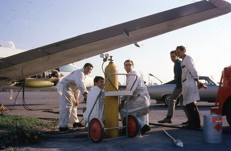

- C-FGYAP-X Andre Belanger pic 2.jpg (43.45 KiB) Viewed 4114 times
- CF-YOK Andre Belanger pic 2.jpg (65.39 KiB) Viewed 4114 times
- ST-27 air tanks Andre Belanger pic.jpg (55.24 KiB) Viewed 4114 times
