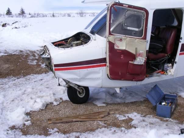

Ah yes. Islander nosewheel was attached to a rather weak bulkhead. Strut was fine but bulkhead was bent untill the nosewheel was "retracted" on a fixed gear aircraft.
