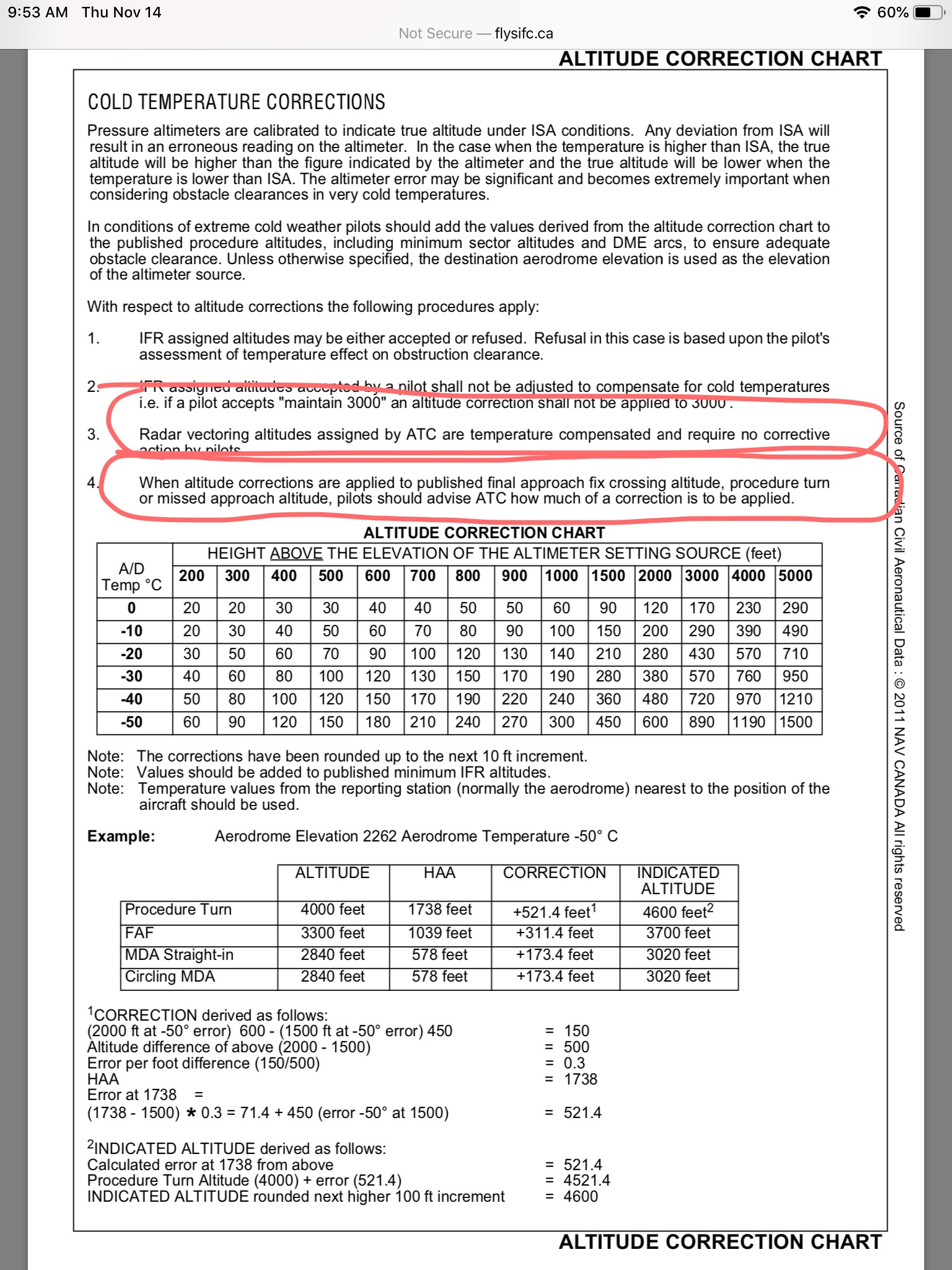

Why rely on an aviation forum?
Go to RAC 9.17.1:
With respect to altitude corrections, the following procedures apply:
1. IFR assigned altitudes may be either accepted or refused. Refusal in this case is based upon the pilot’s assessment of temperature effect on obstacle clearance.
2. IFR assigned altitudes accepted by a pilot should not be adjusted to compensate for cold temperatures, i.e. if a pilot accepts “maintain 3 000”, an altitude correction should not be applied to 3 000 ft.
3. Radar vectoring altitudes assigned by ATC are temperature compensated and require no corrective action by pilots.
4. When altitude corrections are applied to a published FAF crossing altitude, procedure turn or missed approach altitude, pilots should advise ATC how much of a correction is to be applied.

The civilian rules are pretty vague. It only states that in conditions of “extreme” cold temperature, all altitudes should be corrected. What about in not “extreme” cold temperature but below 0? Where is the transition to “extreme”?
The military rules are more definitive. Read page 183 of the GPH204A. https://documents.theblackvault.com/doc ... Canada.pdf.

Where is it written that all missed approach altitudes are exclusively air traffic constraints? If it is not every single missed approach altitude how is a pilot supposed to know whether the missed approach altitude was selected for air traffic or terrain reasons? There are obstacles present in all environments, not just in mountainous terrain. These obstacles don't magically disappear because the aircraft is operating in a radar environment. As PIC your duty is to protecting your passengers, not making the life of a controller easier.
RAC 9.17.1 is pretty clear. You are required to correct the charted missed approach altitude and you are required to inform ATC of the correction. In terms or airmanship, one of the first things you're going to do in a missed approach is communicate to ATC that you're in the missed approach. Adding "climbing to 5200, temperature corrected" takes an extra second. If ATC doesn't want you there because of air traffic concerns they will assign you a radar safe missed approach altitude. If you enter a lost comms scenario and can't inform ATC you're meant to squak 7600 and guaranteed ATC will be clearing all air traffic out of your way until they figure out exactly what you're doing. If after all of that you're still concerned about traffic TCAS provides an extra layer of protection against traffic conflicts. Temperature correction is your only layer of protection for terrain avoidance.
The only real reason people ignore the instructions in RAC 9.17.1 is laziness, pure and simple. Aside from the military instructions posted here (an interesting read) there is nothing in black and white that absolves a pilot from doing it. Talking about airmanship or ATC concerns is vague at best and based solely on some made up opinion about what should be right. Take the extra ten seconds, correct the altitude. It won't kill you but not doing it might.
