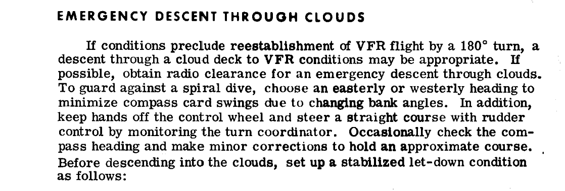

The Cessna 150 manual has a procedure for this.

photofly wrote: Mon Jan 13, 2020 11:38 pm Fine. But with no instruments, how do you know how much and which rudder to use, genius?

No instruments, remember? None.
Sure: whiskey compass, steer east or west, hands off, gentle use of rudder, just like the Cessna manual says. But a whiskey compass is an instrument and you don’t have one.

No instruments, and the whiskey compass is a flight instrument.
Sure: whiskey compass, steer east or west, hands off, gentle use of rudder, just like the Cessna manual says - everyone has read it. But a whiskey compass is an instrument and you don’t have one.
