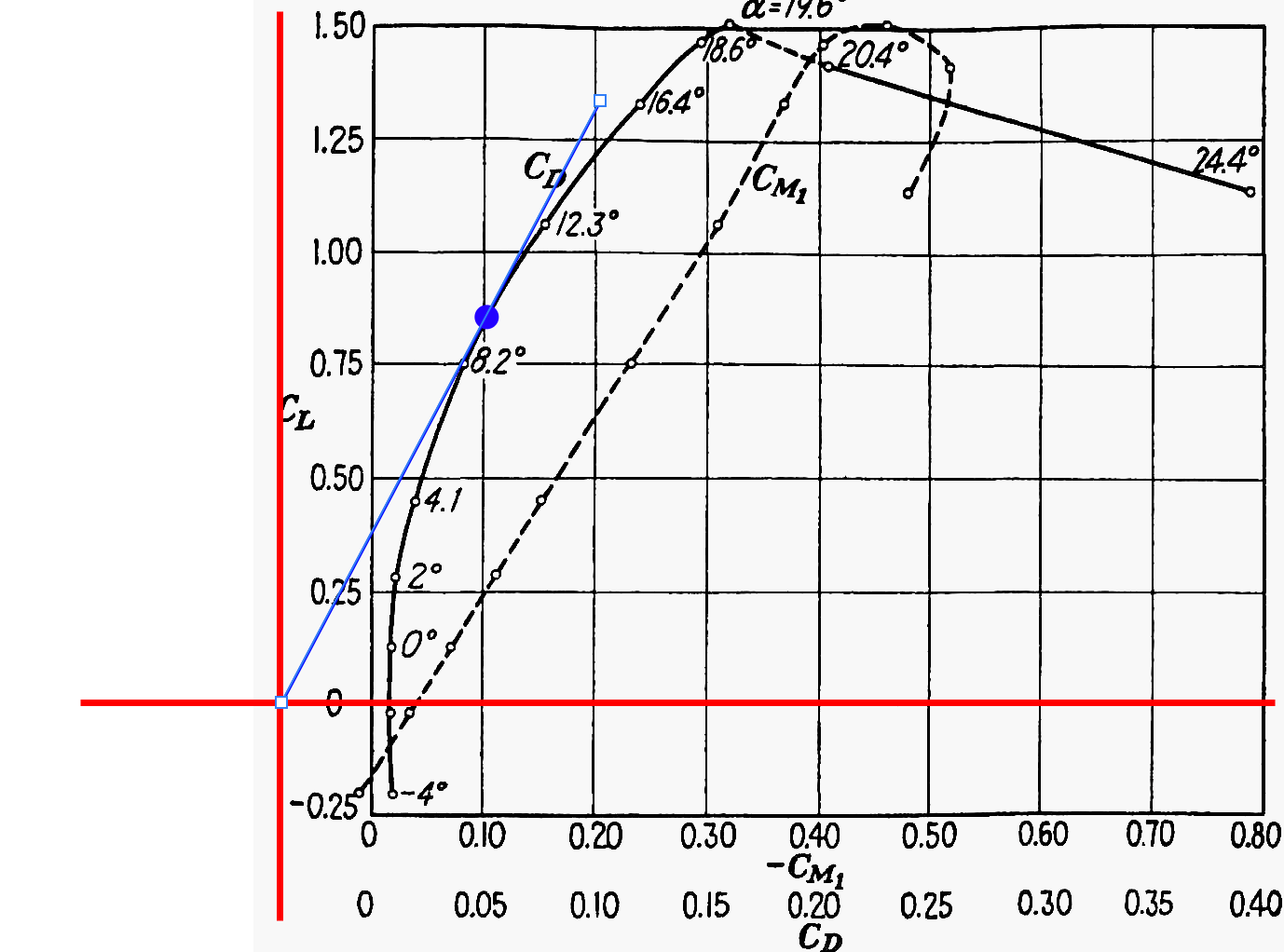

digits_ wrote: Thu Oct 29, 2020 11:29 am Looking forward to the diagrams!
Here's the polar diagram (Cd vs Cl) for the representative NACA2409 airfoil, from Von Mises:
The horizontal scale is stretched by a factor of 5 relative to the vertical scale, because Cd is quite small compared to Cl (it's an efficient airfoil) and otherwise the data is all a bit squished up. The annotated dots represent different angles of attack.
Here's how it applies to a representative airplane:

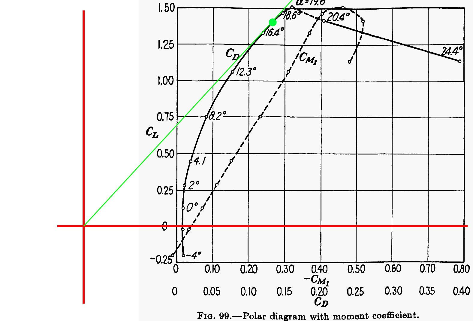

Adding the airframe to the wing results in an increase Cd, (equivalently, the vertical axis is moved to the left) and the blue line represents the steepest value of Cl/Cd available, because it's the steepest tangent. The blue dot is the operating point at (for example) 9° AoA. This represents best glide - and the actual glide ratio is the gradient of the blue line.
If you add more drag to the same airframe the vertical axis moves further to the left. For example:
The best lift/drag ratio that you can get (green line) is considerably worse (shallower) of course, but the AoA at which you get it (green dot) is much close to Cl_max - which is the AoA at which the wing stalls.
So by adding floats, you have:
  • decreased your glide range
  • and increased the AoA at which you achieve that best range
If you add enough drag, your best glide will be *at* the stalling angle of attack, which gives you nothing in reserve to flare with.

You are basically adding all airframe drag to this one airfoil, right?
In the case of a floatplane, the floats also generate a small but significant amount of lift. Using the same reasoning, you would then lower the red axis, in turn increasing the L/D and decreasing the angle at which it happens, no? But since the drag is usually bigger than the added lift, you still end up with a higher AoA and lower glide speed than the clean airplane. Is that correct?

You are using the same drag polar throughout all the examples or am I missing something?
