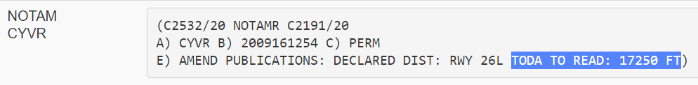

Anyone know why CYVR 26L TODA became 17,250 feet? :rolleyes:

TODA is the takeoff runway available (TORA) plus the clearway. The clearway in this case is half the runway length. The NOTAM is actually correct.

I understand TORA + Clearway = TODA. It just seems TODA is 17250' that's almost 6000' longer than the actual runway length. Just curious is it because 08 end has nothing but ocean(considering the water is the clearway) And what's the TODA like before the NOTAM?

26L TODA before Notam - 12484'
17250' puts it well into the water so why stop at 17250'? How is water considered part of the TODA? Disregard the question, google is my friend. See second attachment....

TP312 5th edition, 4.4.1.3 states that the maximum length of a clearway is half of the TORA, which is why it stops at 17,250'.

linecrew wrote: Tue Nov 03, 2020 2:51 pm TP312 5th edition, 4.4.1.3 states that the maximum length of a clearway is half of the TORA, which is why it stops at 17,250'.
Thank you!
