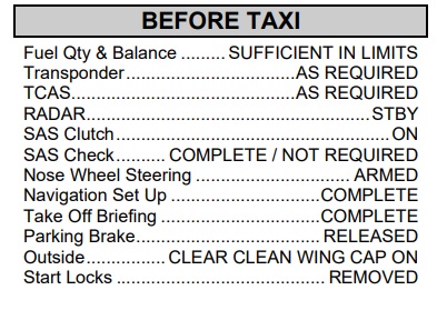

From Perimeter SA-227 Normal Checklist, Revision 9. Start Locks is now a separate check.

throwaway23 wrote: Wed Jul 28, 2021 1:45 pm From Perimeter SA-227 Normal Checklist, Revision 9. Start Locks is now a separate check.
Couple of odd things on this checklist IMO. Maybe a Perimeter person could explain.
What is the difference between a "clear clean wing" and a "clean wing"?
Do you really need "Parking Brake Released" on a Before Taxi checklist?

airway wrote: Wed Jul 28, 2021 9:55 pm
Not really. Just as well do it on the Lineups. If you get that far.

Yes you do.
It could be a “killer item”.
https://www.tsb.gc.ca/eng/rapports-repo ... q0087.html
'clear' is about the prop area, not the wing.
Another example of checklist inflation?

OK, I guess on the Metro it is important :shock:
Poor design if you ask me.
An article about the Metro II parking brakes in the Fairchild Facts newsletter in February 1993 stated the following:
Before taxiing or beginning the takeoff roll, ensure that parking brake is fully released. Just moving the parking brake control knob to the "OFF" position is not enough to ensure release of the brakes. As stated in the AFM, the system requires pressure be applied to the brake pedals to fully release the parking brake since some residual pressure can remain even with the knob in the "OFF" position. Taxiing and taking off with brake partially engaged can result in any or all of the following:
Increased power necessary to taxi.
Longer or MUCH longer takeoff rolls (possibly longer than available runway.)
Hot, burned or seized brake components. Possible fire in the main gear well.
Tire failure on takeoff or the next landing.
Overheated hydraulic fluid streaming overboard from the vent located near the nosewheel well.
Some make it a habit to press the brake pedals firmly to ensure that the parking brake is fully released prior to adding power and beginning to move aircraft.
For the above reasons, Metro II crews tend not trust the parking brake. The brake sometimes stays on after being released, reportedly more often in winter. The company pilots used wheel chocks instead of the parking brakes. Wheel chocks were used while the engines were started on the day of the accident. However, it could not be determined whether the crew used the parking brake between engine start and take-off.

Shouldn’t you have checked that the prop area was clear before starting the engine? If it wasn’t before, it probably is now!
Oh, absolutely. Completely agree with you. Just explaining what is (likely) meant by the checklist item.
Checklists only ever grow, they never shrink.
The checklist we are discussing is done after both engines have are running.
When you remove the props from the start locks it is a blast of reverse and then they blow a lot more air backward compared to when they are on the locks. You want to make sure your ground crew has disconnected the GPU and cleared the area. It’s been 10 yrs but that is the gist as I remember it.
Yes you do.
It is on the Jetstream as well.
As for start locks, I remember that as being one of the last items on the Before Taxi checklist. In my last job working for someone else, I had to write up responses to at least 3 CADORS for rejected takeoffs where that item was missed, the taxi and takeoff run were carried out with the props still on the locks. That led on to another incident, not reported, where the aircraft was near V1 and the FO called Reject where the speeds were not right. The pilot doesn't reject, but slams the throttles backward over the gate, does whatever else is involved in bringing them off the locks, and then rammed the throttles forward and continued the takeoff. That raised some eyebrows.
