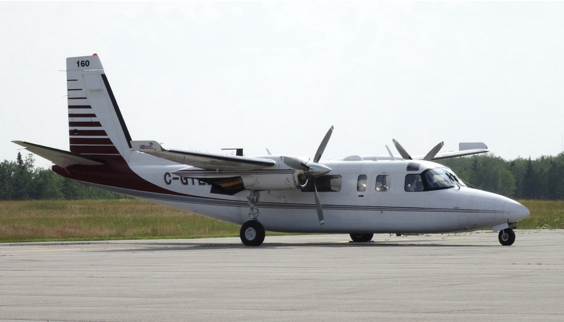

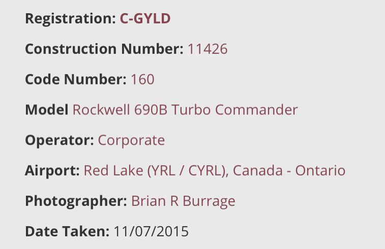

The aircraft in question is actually a “Turbo Commander” with Garrett TPE-331 turbine engines. They will run quite well on Avgas or almost anything that is liquid and burns.
