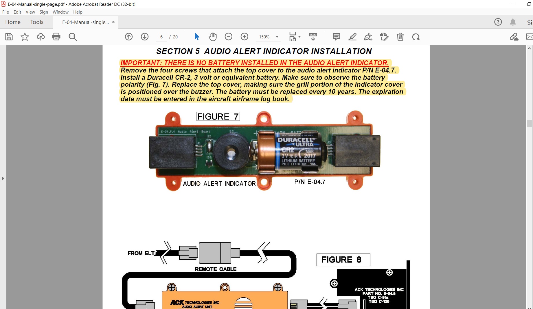

Whenever I bought my plane I discovered that the previous owner had never registered the ELT with the beacon registry. When I opened up the rear avionics bay to find the hexcode I noticed that the previous owner's AME (who had done the annual ELT check) hadn't bothered to secure either of the two straps on the ELT, so the thing was free to fly all over the place in the event of an accident.
Then, after I do a self-test I don't get any email, and I'm told by Trenton that their email system is still in beta and goes down sometime and they'll reset it. This has happened each time I've done a self-test over the past year. That's no big deal, but I'm wondering if I'm the only person who is reporting it to them, or if it just goes down a lot.
Oh, and last time I checked my ELT nothing happened, no beeps, no lights, nothing. Perhaps the ELT battery has died a year early? No, I discover it's a separate tiny battery in the button itself that has died, and it just needed replaced. It turns out the ACK E-04 actually has 3 batteries, all of which are non-rechargeable and will die at some point. In its defence, the ELT will still work if the main battery in the ELT itself is working. You just will have no indication that it's activated, and you won't be able to manually activate it if the battery in the button has died.
I already knew ELTs were crappy technology, but this is just further confirmation. I had gotten into the habit of not bothering to take my Garmin inreach out of my bag for flights over populated terrain, as I thought the 406 ELT was sufficient. But now I don't really trust the ELT at all, and I should never have trusted it.

Well my ELT is 4.5 years old and the 6V lithium battery is down to 2.4V, which caused the ELT switch to not work. I think the problem is the avionics shop installed a no-name battery from Dantona which doesn't have any expiry date on it, and even the manufacturer doesn't list any expiry date in their documentation. In theory you would probably expect it to be 10 years, as it's a direct replacement for the Duracell 28L that has a 10 year life and it uses the same technology. But I guess if you're one of the largest avionics shops in the country and choose to install a piece of shit battery that might have been sitting on your shelf for years then this is what happens.

The Duracell is C$10.41 on Amazon, and the crap no-name battery that the avionics shop installed is US$12.34. Anyway, my point is just that the ELT design is crap and prone to failure.

CpnCrunch wrote: Sat Oct 09, 2021 4:52 pm I think the problem is the avionics shop installed a no-name battery from Dantona which doesn't have any expiry date on it, and even the manufacturer doesn't list any expiry date in their documentation.
Did you actually read The ACK-E-04 install manual? It clearly says the system has 3 batteries and the replacement time frame.
Yes, I've read the ACK manual. That's how I figured out there were 3 batteries and replaced the one that was dead. I was talking about the battery manufacturer (Dantona), which the avionics shop installed when they installed the new ELT in the plane 4 years ago. They don't give an expiration date for their batteries in any of their literature, and there is no expiration date marked on the battery itself. This is the 6V battery for the switch, not the main battery in the ELT.
