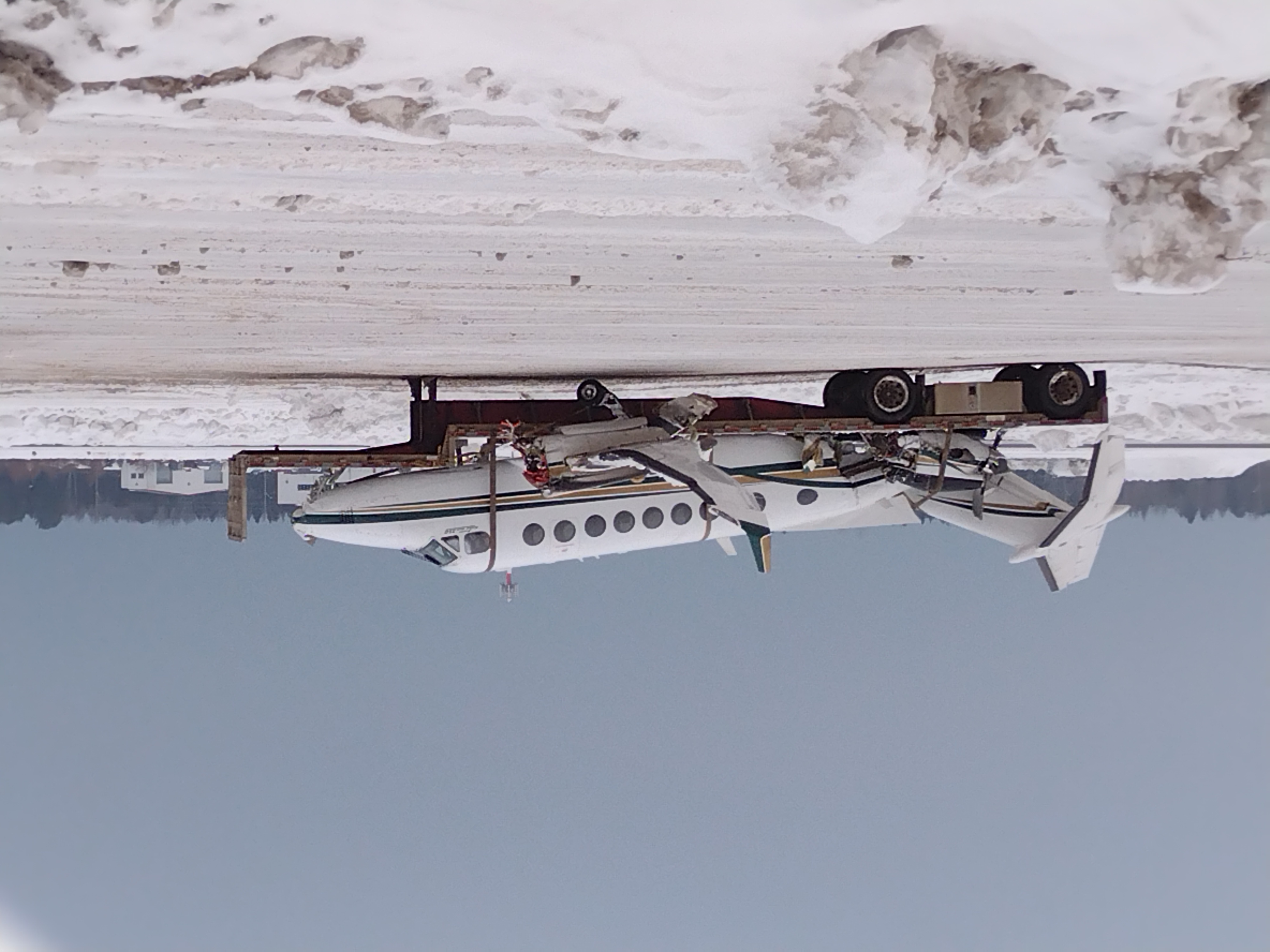

Right in front of employee parking lot.
rudder
Posts: 4235
Re: King Air in YQT
Post by rudder »
That is one seriously broken airplane.
Definitely headed for the scrap heap.
