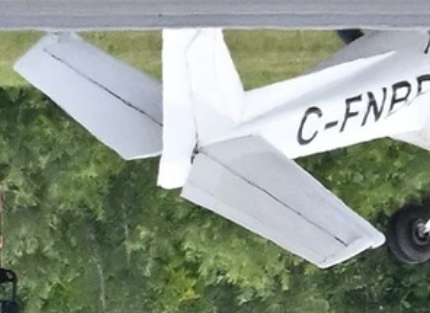

This photograph (Montreal gazette) shows the elevator matching the locked position (as far as I recall):
This one shows the rudder is displaced, but the ailerons still neutral (again, matching the locked position:
In both cases the control system could have been (and looking at the distortion of the tail on impact, probably was) disrupted or displaced by the impact deformation of course.
