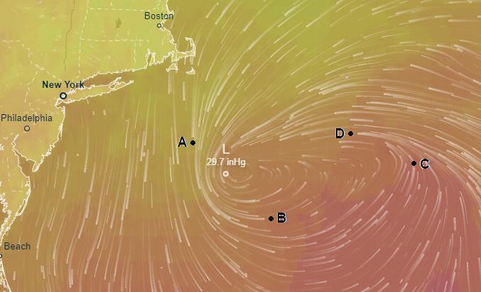

I don't get it ? Here are 4 points A, B, C, D, where at each point "the temperatures to the southeast today are warmer than those to the northwest". The wind direction is from the north at A, from the west at B, from south at C, and from the east at D.
