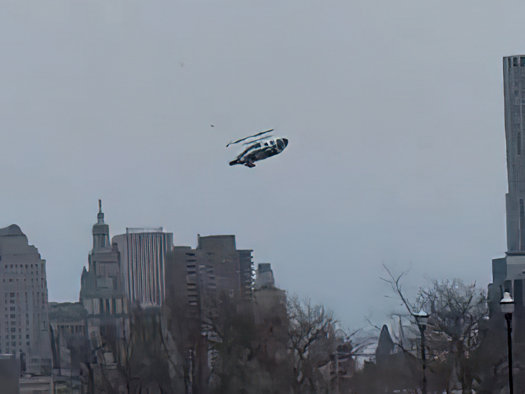

Attached is an enhanced still taken from the video.
Enhanced still from the video.
Screenshot 2025-04-10 185515.jpg (402.38 KiB) Viewed 2801 times

Related video shows the mast, blades,transmission as an intact unit hitting the water nearby shortly after the helicopter impacts. Actually the tail boom comes off first, then the tranny/rotors. Odd for the transmission to rip out of a flying helicopter. 206L, maybe some Heli guy can comment on the suspension system attaching it to the airframe.
