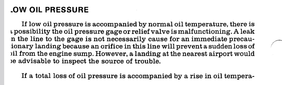

A U206G POH that Google found has no low oil pressure checklist, but has the attached expanded procedure which continues to say if there is a total oil pressure loss and oil temperature also rises to make a forced landing with minimal engine power as an engine failure is likely imminent.

The above reference from the POH does say that an inspection at the nearest SUITABLE airport is advisable to be completed. Not necessarily continue the flight.
