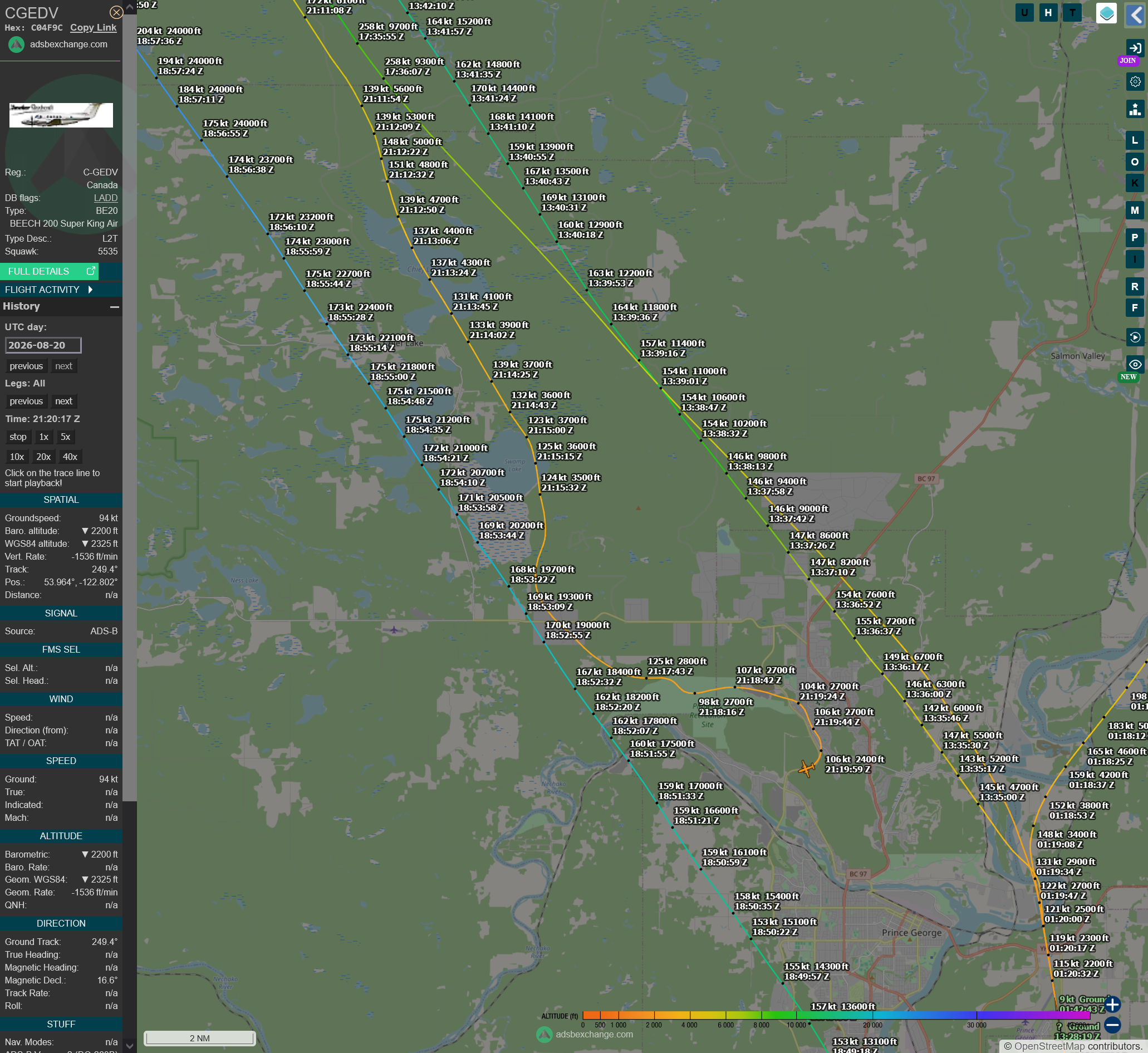

From ADS-B, this was the second of two round trips to Sturdee that day. About 260nm. They were on the ground at YXS for an hour, ought to be time to refuel.
yrp
Posts: 71
Joined: Sat Sep 16, 2006 8:39 pm
Re: BE20 forced landing Prince George
Post by yrp »
Here is the ADS-B track from adsbexchange.com:
https://globe.adsbexchange.com/?icao=c0 ... rackLabels
Previous track for the day shown for comparison.
GEDV - Copy.png (1.92 MiB) Viewed 1517 times
Posts: 4812
yrp wrote: Mon Aug 24, 2026 1:57 pm
Could it be contaminated fuel after an hour or two of flying? (An actual non rhetorical question, I would assume not, but happy to hear from someone more knowledgeable).
From someone working near Sturdee, fixed wing charters are not typically refuelling at the airstrip. They think there is fuel there for the helicopters though.
It's a stretch for sure. The PT6 will burn any flammable liquid, so the wrong fuel type wouldn't lead to a failure. Water or debris could certainly take an hour to become a factor, water causing ice crystals at altitude, and blocking fuel filters would take time to develop, but Pratts have oil to fuel heat exchangers that should mitigate this, and the chance of that affecting both engines is remote. Conceivably some kind of contaminant causing an engine problem and then mismanagement by the crew maybe, or a mismanaged fuel leak.
More than likely, the contaminant was air in the tanks. Beech capacitance type fuel gauges are notoriously inaccurate when not expertly maintained, but any competent pilot knows not to trust them and use a calculator with fuel receipts to back up the gauges.

While it may initially have looked like running out of fuel, an aircraft that maintained 2700ft for 90 seconds while slightly increasing groundspeed isn't out of power from both engines. Something else is going on here.
