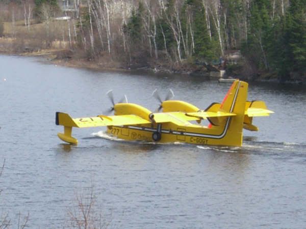

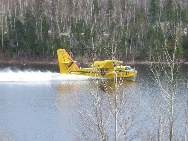

While we're at it...
arsenal
Posts: 78
Joined: Mon Feb 16, 2004 11:59 am
Post by arsenal »
Driving Rain
Posts: 2696
Post by Driving Rain »
AWESOME shots arsenal. :supz: :smt098 :smt023
