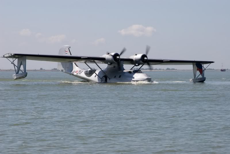

Hell, I can tow the banner and Hedley in his Pitts with his banner with a Cat.
Here is a picture of the Cat the guys sent me a couple of weeks ago in Holland.
http://i43.photobucket.com/albums/e353/ ... ally-1.jpg
