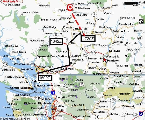

The pilot of the Montair Aviation Cessna C150 filed a VFR flight plan from Boundary Bay to Kamloops (CYKA), with a departure time of 1509Z and an ETA in CYKA of 1800Z with 0430 endurance. He called CYKA Flight Information Centre at 1642Z reporting over Lytton. He called at 1729Z reporting 3 South of Kamloops Lake. At 1750Z he called to say he was lost and requested help in orientation. Because he was unable to provide sufficient information, he was asked to contact Vancouver ACC. The pilot contacted Vancouver ACC at 1751Z at 6,200 feet, which was below radar coverage. He was asked if he could climb but stated he was unable because he was very low on fuel. At 1755Z the pilot broadcast a MAYDAY stating he was landing on a farm field by a highway. No other information was provided. The Rescue Coordination Centre (RCC) was alerted. Aircraft were tasked to Williams Lake, ELT composite was formed and aircraft tasked to ELT area. The aircraft was eventually located at 2025Z 20 NM Northeast of 108 Mile Ranch on a farm field (5154.64 12109.17). There was no persons on board. The company called RCC to advise they were in contact with the pilot and everything was safe and sound. No damage or injuries were reported.
He departs at 1509 with 4.5 hours of fuel for a 3 hour flight (ETA 1800). Declares an emergency at 1755 2.8 hours later, out of fuel.
Even if he didn't get lost he would of ran out of fuel before reaching his destination.

My question is
"How did he take his 152 from Kamloops lake to 108 mile house in 20 mins?"
Last edited by jon_upsidedown on Sat Oct 20, 2007 7:38 pm, edited 1 time in total.
- Rank 11
- Posts: 3239
He didn't. He obviously thought he was somewhere he wasn't. If he found Kamloops Lake and was VMC, he'd have a hard time not finding Kamloops. If he followed the Thompson up to from Lytton to Cache Creek, continued towards Clinton rather than turning east, there are a couple lakes northeast of Clinton he might have confused with Kamloops Lake. 20nm northeast of 108 mile from 3 south of Green Lake, say, seems much more reasonable in 20 minutes.jon_upsidedown wrote:My question is
Not saying that's what happened, just that he likely never was at Kamloops lake.

heres my 2cents i remember from memory,, he got to hope no problem,,, easy enough he goes north... uses lytton as his marker to turn east,, however he uses the lytton airport THINKING hell see an actual paved runway.. to his surprise there is no paved runway in lytton its an abandonned dirt almost sandy like strip.. totally misses it.. keeps going north until he hits Lillooet where a paved runway with an "opening" in the rockies to the east.. . he takes that "opening" to the east goes north... towards 108 mile or CYWL or wherever... notices hes lost once he gets into a clearing due to the fact that his planning had no major openings in it..
thats just my thought on what happenned
