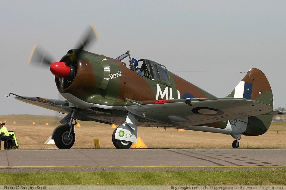

I have to stick my foot in my mouth a bit here. The Wirraway was intended only as a training airplane but accidently got pressed into service in WWII as fighter; briefly.
http://en.wikipedia.org/wiki/CAC_Wirraway
I was thinking of the Commonwealth Boomerang which used 'Harvard' components but an entirely different fuselage and an R-1830. (That's a geared engine, just in keeping with this thread..)
- CAC Boomerang.jpg (136.21 KiB) Viewed 4031 times
