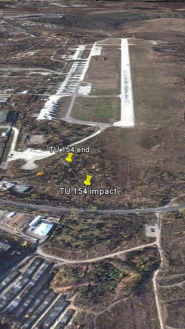

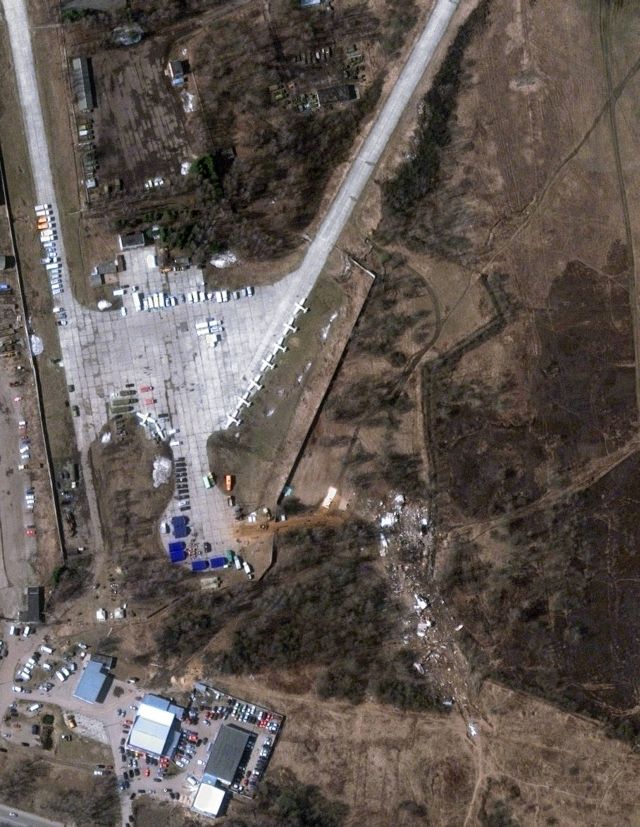

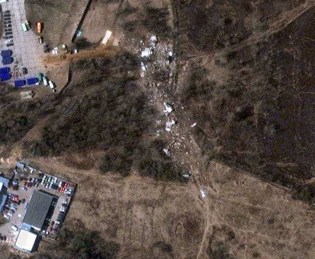

I've been reading up on this accident and honastly, I was shoked to see that the common speculation was an angle of bank of this magntiude at impact. Even though they may have assumed they were higher than they thought, they would know of their approximate distance from the ground because they were near the airport and any aircraft doing that kind of banking near the ground, in the visibility they were encountering is quite surprising.flyinthebug wrote:it seems the aircraft was in a 70-80 degree bank at impact.
Really, in all, this accident is a unfortunate combination of events and situations that lead to a very tragic disaster.

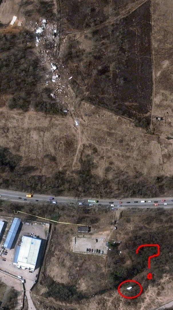

Lost in Saigon, great pics! Im obviously not the only one who noticed what you have red boxed with a ? Am I the only one that thinks that looks like a piece of the elevator?
Re: Polish Pesident Dies in Crash
From the looks of it, it would appear to be the elevator from the left horizontal stab...flyinthebug wrote:Am I the only one that thinks that looks like a piece of the elevator?
Give me a mile of highway and I'll show you a mile; give me a mile of runway, and I'll show you the world!

Speculation is that the first impact was before the highway.
Speculation is the key word --- from looking at the field around that "supposed" elevator, it seems a bit out of place (nothing else around). Although it looks like the left evelvator of an aircraft, it's likely just a peice of tin or metal scrap...Lost in Saigon wrote:Speculation is that the first impact was before the highway.

This could explain how a wingtip may have been the part which separated prior to where the rest of the aircraft impacted the ground.flyincanuck wrote:It didn't mention that the information was from the CVR/FDRETOPS wrote:Anyone know Polish? Is this ANIMATION derived from onboard data?
It said that circled the airport three times to "become familiar with the topography".
On the approach they hit a radio station (antenna), and trees (depicted in the animation).
