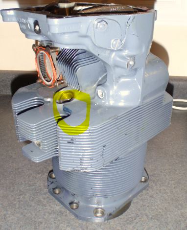

I've owned both PA31 & PA31P's
I paid particular attention in high altitude descents on the P, but still managed to crack two cylinders over time.
Both were found by regular inspection.
Both cracks were right around the fuel injector!, pretty much in my mind the crack hazard is indeed mixture
related and not as much power related.
Ironic, I also always landed mixtures as leaned in descent and cruise prop settings (unless IFR down to min)
Believe it or not of the PA31's I've owned and flown - the P was my favorite :) (Except for the 85 Gal/hr climb...)

Both cracks were right around the fuel injector!, pretty much in my mind the crack hazard is indeed mixture related and not as much power related.
Exactly! (sounds of Hedley jumping up and down). Everyone propogates this "inch a minute" power reduction of MP during descent, when in fact it's completely irrelevant. You don't apply power on takeoff using the "inch a minute" rule, do you?
I really wish we could somehow get the word out that cracking cylinders is caused by jamming the mixtures in. Don't do that.
Approach and land with the mixtures leaned, and the props at cruise RPM.

trey kule wrote:I've got time on the p model too.. I actually quite like the little rascal..lol on the fuel flows...I could never get them near what the book claimed even in cruise.
Never had a problem with cylanders. Flew one engine 200 by TBO and it worked just fine until the case cracked.
A "P" is the best value on the market in that size IMHO - I looked at Cheyenne's initially but at about 30% of the initial cash outlay the P was a winner!. Lycoming claims the TIGO-541 was the most complex engine they ever build and that problably holds true to this day. in "top" cruise I burned 54 Gal/HR @ 230 KTS - at an approx cost of $425 /hr it's quite the machine for the money - until you crack the case.....
Here's a pic of how the cylinder crack was noticed. Fuel stain on cooling ribs travelled up from fuel injector.
