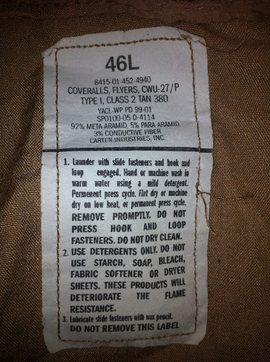

You can wash a flight suit without damaging its fire resistance. HOWEVER, do not use any sort of fabric softener, (either in the washing machine or in the dryer). Fabric softeners/anti static cling sheets (Downey, Bounce etc) all contain paraffin which will seriously degrade the protection the suit gives you. Also, don't leave Nomex sitting in the sun for a long time. Don't ask me how I know this as I will not incriminate myself.
As was pointed out previously, if you want burn protection you need a second layer under the suit, (cotton works well). Nomex doesn't burn easily, but it is a poor insulator. This means that even though the suit does not burn, the heat will still pass right through it and into the wearer. The second layer helps to keep that heat out, while the Nomex prevents the inner layer from burning by blocking atmospheric oxygen. There have been a number of cases that illustrate this point. The one I recall seeing was where two pilots where caught in a refueling fire. Both had Nomex suits. One had a full second layer, the other did not. The fellow with the second layer came away without very much in the way of burns on the torso/legs (everywhere that had two layers). The other fellow was one massive second degree burn.
