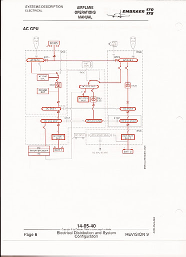

I had a good look through the manual for the E190. The only thing I can think of are numerous blown CB's, both thermal and electronic. It doesn't state ground protections in the case of lightning strikes.
It looks like the discharge came from where the RAT is located.
Here is the schematic of the AC system under GPU power. Someone who knows how to read greek care to answer MIQ's question?
