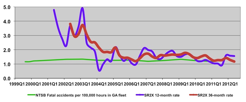

Accident rates need three things: # fatal accidents, # flying hours, and a time period.
At the Cirrus Owners and Pilots Association (the other COPA 8) ), we track the # fatal accidents all over the world. As of today, 91 fatal Cirrus accidents. That's slightly more than the common source from the NTSB database because it includes all known foreign accidents, including Canadian ones, that do not get included in the US-based NTSB database.
Cirrus Aircraft trackes flight hours using times submitted with warranty cards, completion cards for service bulletins and airworthiness directives. They then create a reliability distribution of flight hours for the Cirrus fleet of about 5,200 aircraft.
Then we plot the 12-month and 36-month fatal accident rates. Longer intervals smooth out the effects of a small population. With only 1 in 30 registered single-engine piston aircraft, small numbers of accidents create big swings in accident rates.
Here's the plot of the Cirrus fatal accident rate since first introduction of the SR20 in mid-1999.
Comparisons with the NTSB fatal accident rate show that the Cirrus rate has declined over time to a level inconsistent with the claim of three times a Cessna rate.
Cheers

It's not the airplane, it's us, the pilots. 94% of NTSB probable causes of Cirrus fatal accidents were pilot-related.
Rick - from your statement above, it would appear that you agree with my evaluation of Cirrus pilots a bozos.
And even though you claim fixed-gear is irrelevant, I can assure you as someone who has been in aviation for many decades, that it was a brilliant marketing move to get low-time pilots into an airplane they could get insurance on.
No, I do not agree. Nor do I agree that 70-80% of the pilots who are determined to the probable causes of other general aviation accidents are bozos. They may have poor pilot skills, lack proficiency, made a mistake -- but they paid a death sentence for that situation. And nowhere but here do they get called a bozo.

The fatal accident rate of Cirrus aircraft continues to trend downward as the fleet increases and planes fly more. And the Cirrus community continues to grow by attracting more people to personal air transportation.
Do you really think that we could get there if people still called Cirrus pilots "bozos"?
