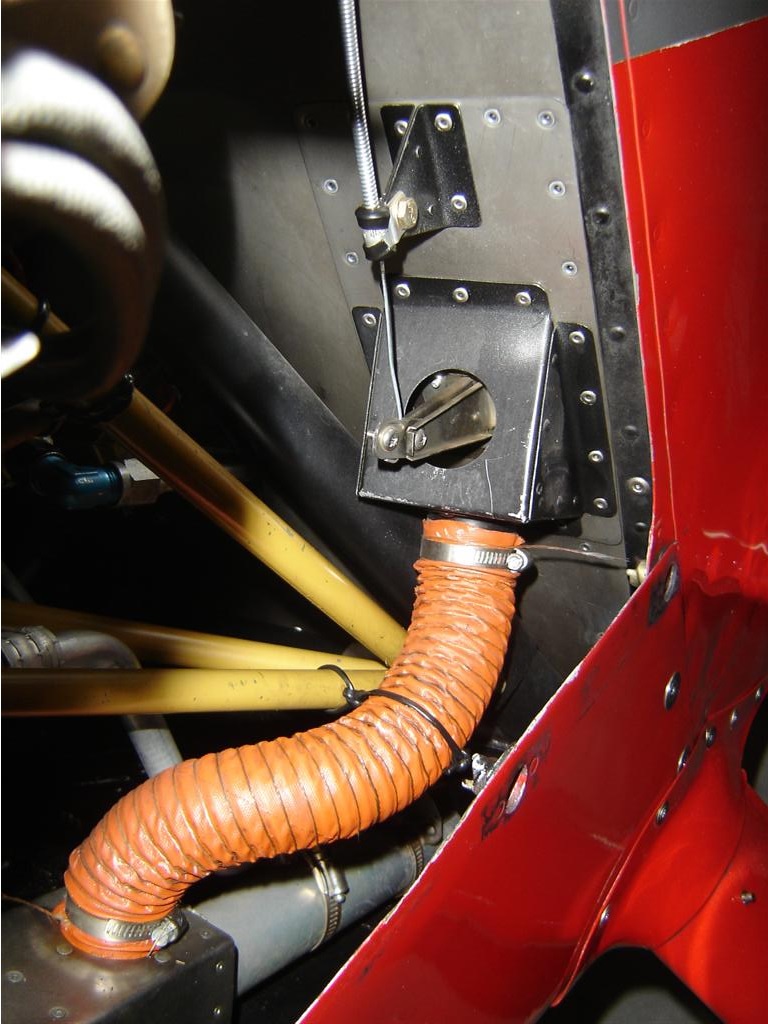

GyvAir
Posts: 1817
Re: Cabin preheat ideas
Post by GyvAir »
ahramin wrote:Your T18 takes it's cabin heat from the engine compartment? Sounds scary.
I had the same thought when I read it, but after thinking about it a minute it makes sense:
Heat Control.jpg (183.02 KiB) Viewed 3136 times

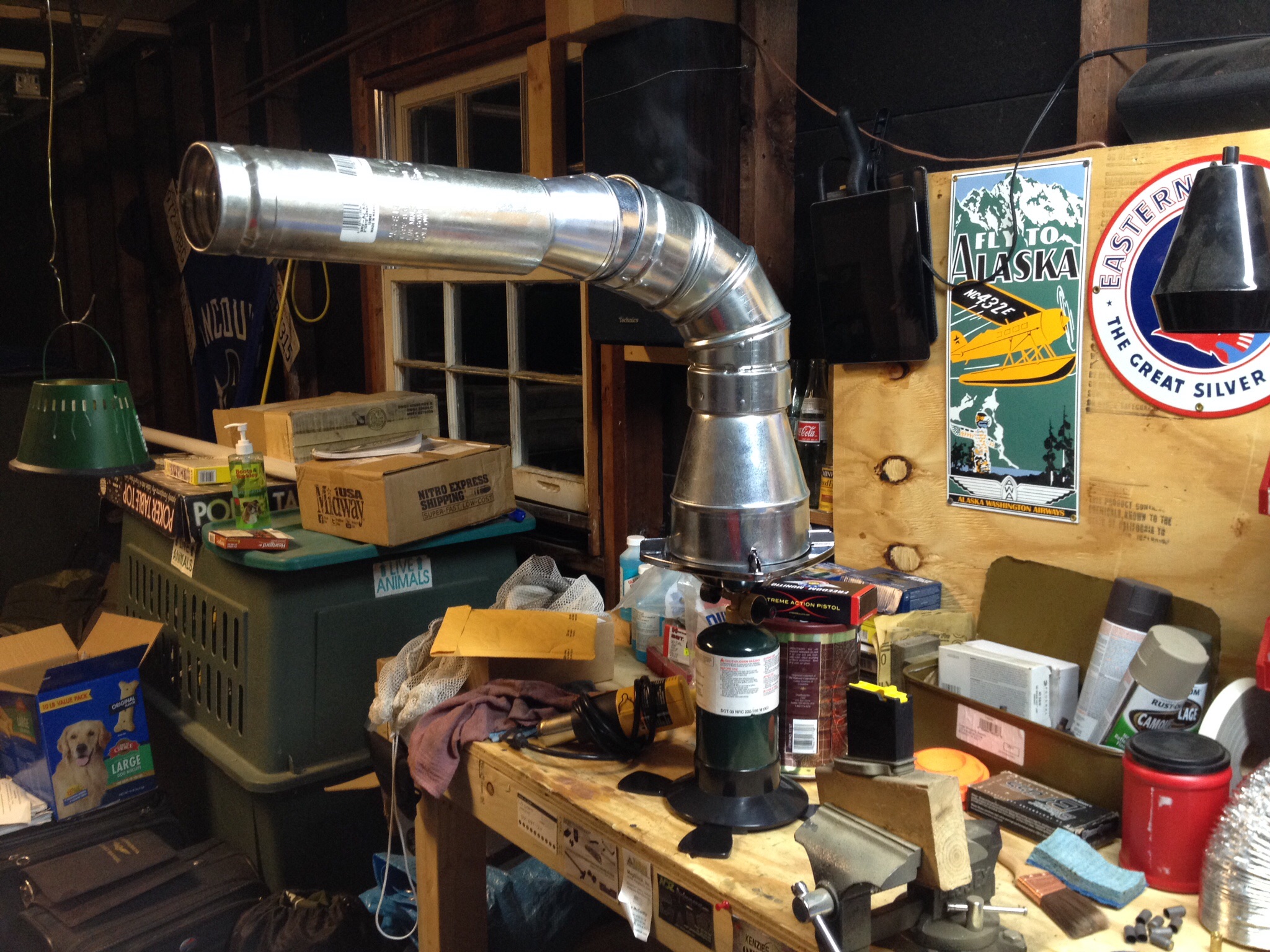

I stole this idea from a J3 forum elsewhere.
I bought a $20 propane single burner stove. (10,000 btu)
Then spent about $25 at lowes for a 6->4" adapter, a 90* elbow, 4->3" and a 12" tube.
I think she'll do the trick just fine. Puts out enough heat. The exterior doesn't get nearly as hot because of an inner core.

PilotDAR
Posts: 4113
Post by PilotDAR »
I would heat the cabin electrically only. Anything else will introduce problems in excess of and benefit. I would not worry about the gyros, or other systems being cold. For the temperature range you'd be willing to fly, they would not be bothered. Just assure everything is warmed up a bit and operating before flight.
Burning any quantity of propane produces 1.6 times its weight in water; or water of about 80% of the volume of the liquid propane.

Nark wrote:I stole this idea from a J3 forum elsewhere.
I like it, except.
photofly wrote:Burning any quantity of propane produces 1.6 times its weight in water; or water of about 80% of the volume of the liquid propane.
Possibly not noticeable in the Bayou with all the nice humidity but up here in winter wonderland once humidity gets frozen into people's car interiors it's the gift that keeps on giving. Frost, fog, moisture...
I would build some form of heat exchanger for that propane heater to separate the moist combustion air from the dry air you want heated then introduced into the cabin. A small computer fan run off a rechargeable battery would be bonus as it would then be a nice forced air heater.
Simplest would be, use a double walled pipe with a 6" diameter elbow on the outer wall, use a 4" sheet metal reducing adapter down to the smallest they have then attach it to the inner wall where the flame will be, cut a hole at the top of the elbow to run that small chimney straight out. Go with the other reducers after the elbow for the dry air into the cabin. Seal the chamber and cut the small computer fan into the side of the outer double wall to push the cool ambient air into your furnace.
