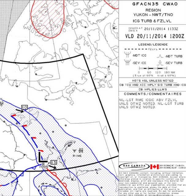

Glad this turned out almost a best case scenario considering what has happened in other situations. I believe the ATR for Hay River departs at 0700 and had reported tops to 16000 with light rime (as per the atc recording).
I went through this disturbance yesterday and tops were over 22000 and temps at -20 at the top and much warmer below.
I don't think the TAF was calling for the freezing rain but it was coming down pretty hard here this am and when I heard a plane going to Simpson went down I had memories of Winnipeg but thankfully it worked out much better.
Here was GFA this AM. Patchy mixed to 14000, no FZRA forecast like it was yesterday for the SW of the territory. Also FZRA warnings for all of northern Alberta with same system today.

I thought the booted caravan was already prohibited from flying in moderate or greater icing:
http://www.airweb.faa.gov/regulatory_an ... -10-15.pdf
The GFA posted above appears to show moderate icing from 2500 to 4000.

trey kule wrote:GFA is a broad area forecast....is is not gospel
There were PIREPS regarding the cloud thickness and icing conditions.
Regarding icing, shouldn't the GFA be taken as gospel unless you have a PIREP saying there is less icing than forecast?

As per the GFA I cut off the description of icing which is in the top left hand corner. It was 2000-14000 in the area over YZF for 12Z. If the GFA was gospel people wouldn't fly half the time. I remember checking the icing GFA after the Winnipeg C208 crash and it was calling for icing all the way to 17000 from YWG past YQT but after the crash it was amended to show a red band of severe clear ice in FZRA over YWG and east...Even with that GFA there is no red band to report severe icing in freezing rain although the entire northern half of Alberta was under public freezing rain warning and was actually receiving it. Why the public forecast and aviation forecast differ so much some days amazes me.
Caravan is good to transition ice but if you can't get free of it you better hope the ice is frozen on the surrounding lakes you are flying over I guess. Fortunately I never experienced icing issues in a Caravan, but having an acute paranoia of sitting in it when you can go from cruise speed to best angle with max power in a short amount of time might of helped.
