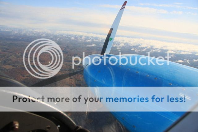

Wait. You actually shut the engine down in flight?I actually shut the fuel off in cruise,
Re: ME training..
No. turning the fuel off is not a "shut down" windmilling prop is not a "shut down"
Shiny Side Up wrote:Wait. You actually shut the engine down in flight?I actually shut the fuel off in cruise,

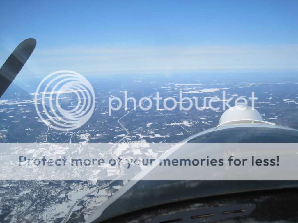

Its clear you are not and owner, and is also clear you do not understand shock cooling..If I were an owner I would sh1t can anyone who did this to an engine in the cold wx and operating piston engine a/c there would be no winter training allowed at all.
I have always tried to muster up the balls to shut down, and feather both in an AC50... Maybe someday
Re: ME training..
Yeah, shutting down an engine in flight is not my preference, however, some certification flight testing requires actual shut downs to demonstrate compliance of Vmca, and feather/unfeather function for two. Indeed, one of those tests turned up a system malfunction which was really worth knowing about. After a fix, and retest, it was a pass.
My inflight shut downs are planned, and preceded with many minutes of gradual cooling, and then a long warm up after restart, before power is developed. No snapping engine controls up and down - very gradual whenever possible...... I know that pilots like to be confident that the aircraft will do what it should when required, so at some point, it's gotta be tested.

Big pistons,
I was turning off the fuel moments after a take off in the air.. (and no the altitude we were at the engines are not harmed by sudden stoppage due to a fuel supply interruption)
I have run tanks dry in cruise in singles and twins and have NEVER had any issues caused because of it.
