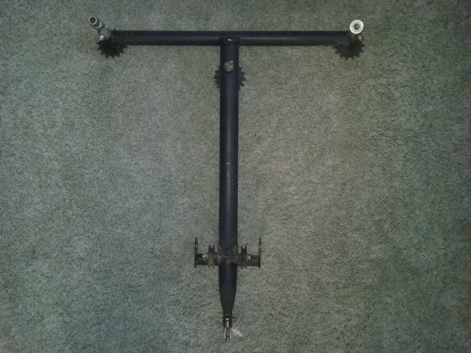

Photo below is from a current Ebay listing for a similar t-bar assy.. still in one piece!

Thank you GYVAIR. Yes, I saw that photo on E-Bay as I queried same shortly after the incident as I was not familiar with the T-Bar assembly. Even though I teach ground school, everything is dedicated to the engine and aircraft control, "surfaces", etc. How the aileron and pitch controls are connected to the control yoke has never been subject to any attention. . . . . until now!
