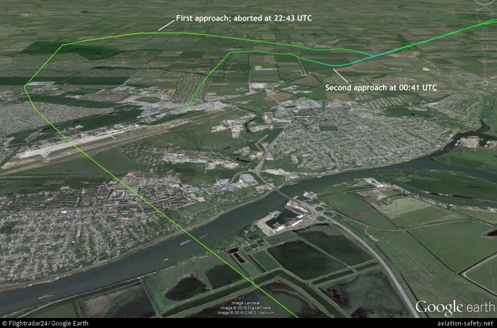

Hardly black box material, but this 3D profile map from ASN of the two approaches shows a very steep final decent.

GyvAir wrote:Hardly black box material, but this 3D profile map from ASN of the two approaches shows a very steep final decent.
https://aviation-safety.net/photos/disp ... r=2&kind=G
i'm not getting the 3D ishness of this. Are those lines not simply the tracks over the ground?

Yeah, the "3D" flight profile rendering is rather lacking. Here's the 2D version of the approaches and first go around.

From ASN:
The flight left the holding pattern at 00:28 UTC (03:28 LT) and descended towards Rostov for another attempted approach to runway 22. The aircraft crashed on airport terrain during this attempt. ADS-B data recorded by Flightradar24 show the aircraft descending to an altitude of 1550 feet when it began to climb again at 3 NM (5,6 km) short of the runway. It reached about 3975 feet until the airplane entered a steep descent before impacting airport terrain.
So it aborted the approach, climbed, and then descended, which is even more baffling. My first thought on reading that was that the crew executed a missed approach, saw the runway, and tried to force it down, but commencing the missed approach three miles from the runway and climbing 2500 feet before descending again doesn't fit with that. Even more, it doesn't fit with wind causing the accident.
