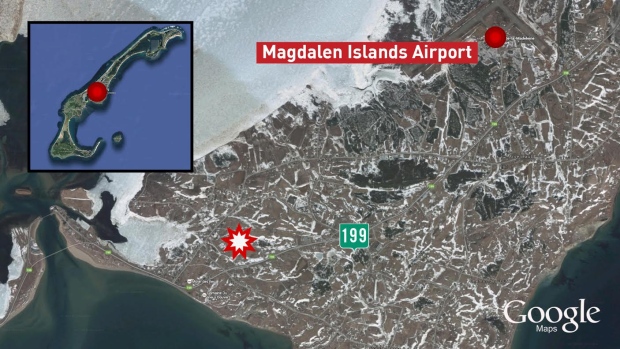

TSB says 2km north, however the news reports are saying it was near Chemin Richard, about 3km SW of the threshold of runway 08.
Anything north of the airport appears to be either water or open land; no houses as shown in the photo backgrounds.

That would make more sense for cfit. Could well have been an altimetry issue.

I'm not familiar with the approach path here in relation to where the aircraft ended up but this situation/weather kinda has the ingredients to a frozen P2T2 sensor perhaps??? Might have been high on decent/approach with the power pulled way back allowing insufficient anti icing of the senor? Just a guess, but if they crashed short on the approach it might indicate insufficient power to stay on profile if they went to add some juice and the levers had little to no response. Maybe totally off but I do know of this happening elsewhere with Metros, etc...
