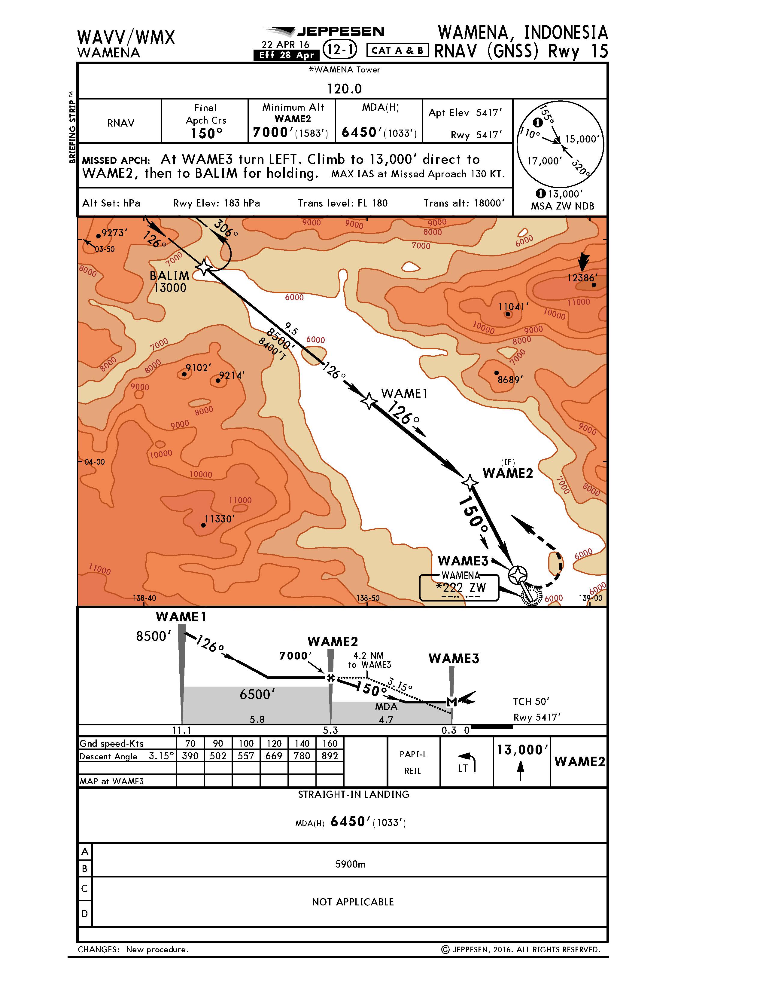

From another forum they are saying there are no instrument approaches into that airport and the ceiling at the time was below 200'.
Gannet167
Posts: 589
Joined: Sat Jan 19, 2008 12:23 pm
Re: Trigana Air Boeing 737-300F skidded off the runway at Wamena, Papua (video)
Post by Gannet167 »
There's an RNAV 15, CAT A and B only, with minimums 1033' AGL.....

Gannet167, is there a link to the RNAV 15? I'd like to have a look even though I'm sure the 733 is a Cat C. Thank you.

This is the only one I can find. 5988' X 98' runway.

Gannet167 wrote:There's an RNAV 15, CAT A and B only, with minimums 1033' AGL.....
737-300 isn't certified for RNAV (GNSS) approaches.
Donald
Posts: 2451
Post by Donald »
Eric Janson wrote:737-300 isn't certified for RNAV (GNSS) approaches.
You must mean this operator isn't certified for RNAV approaches.
Because both the Classics and Jurassics can be certified for RNAV approaches, at least in Canada.

I did some checking and I see you are correct - the 737-300 can be upgraded with GPS receivers and an updated FMC which will give RNAV(GNSS) capability.
The 737-300's that I flew did not have this capability. I don't remember ever flying an overlay type approach - all strictly raw data.
Given the cost of retro-fitting vs. the residual value of the airframe I doubt Trigana Air did any modifications.

There it shows the turn with rapid descent initiation from level at MDA (see chart).

The captain probably chopped the thrust when the runway came into view and did a dirty dive and line up with the runway. Seen it done in various turboprop types but not a good idea in a jet like that.
Wouldn't be surprised if the aircraft had a GPS/FMS of some sort and were attempting to follow the published procedure or some sort of homemade procedure. It happens quite a bit in certain areas of the world. Obviously it wasn't done in a particularly stable manner.
