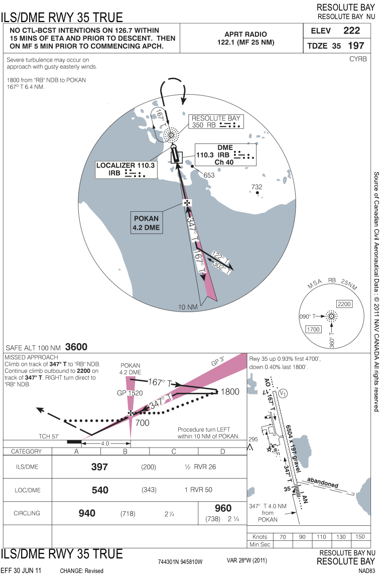

another_try
Posts: 25
Joined: Sun Feb 20, 2011 4:07 pm
Re: Resolute Bay Accident - Pilots Discussion Thread
Post by another_try »
Has anyone noticed that there is no missed approach point for the LOC/DME approach on the ILS/DME 35T plate? Not on the DND copies anyway. Take a look. Page 325 in the previous set of pubs that expired yesterday.
Were they intending to fly the LOC approach, dialed in & tracked the VOR by accident, and were then fudging the MA point, since one wasn't published for the approach?
Buddy has a point.

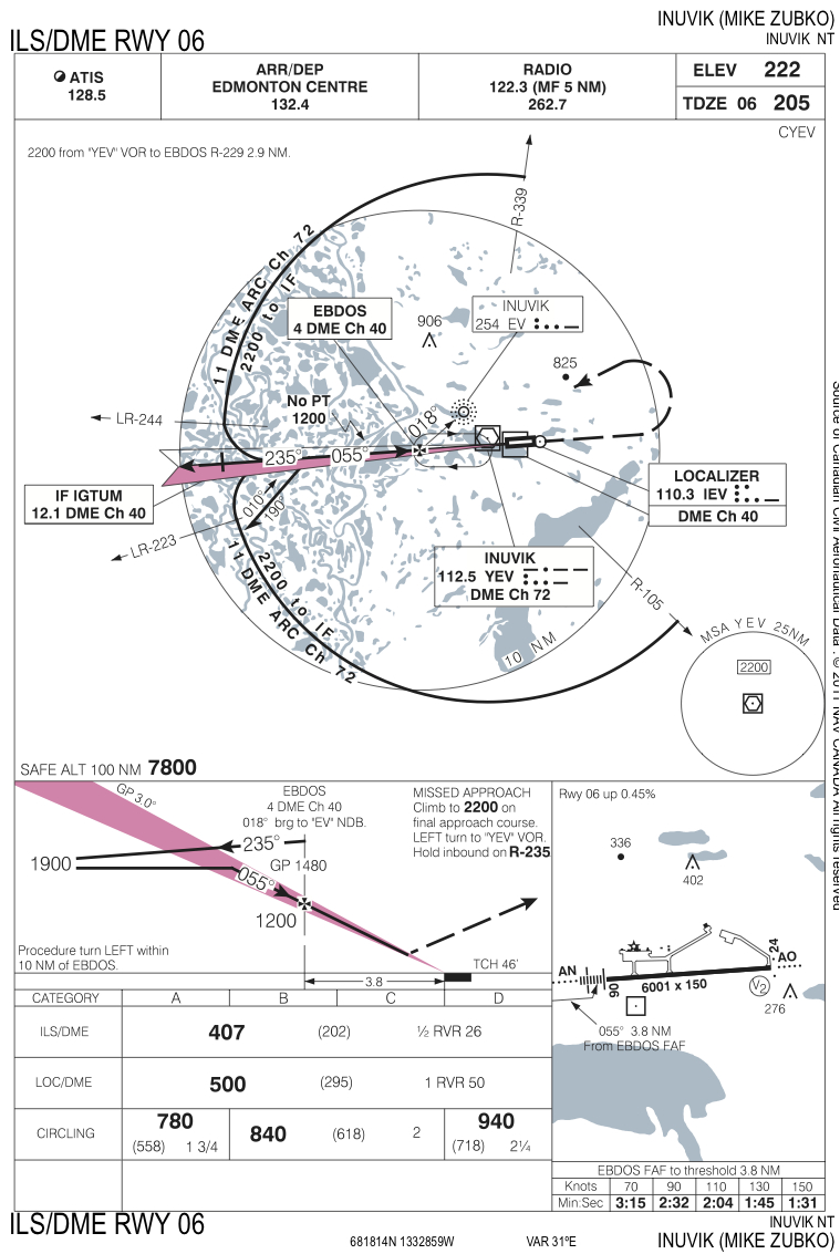

privateer
Posts: 508
Post by privateer »
Inuvik does.

another_try wrote:Has anyone noticed that there is no missed approach point for the LOC/DME approach on the ILS/DME 35T plate? Not on the DND copies anyway. Take a look. Page 325 in the previous set of pubs that expired yesterday.
I was wondering about that. It looks like down to 540 after Pokan, then track inbound until 0 DME? Which is at the far end of the runway? There is no timing. If they were tuned to the VOR, the DME would have been coming off it.
It might also be possible to misidentify, given that the code pattern for the last two letters is the same for IRB and YRB.
The real issue is the track inbound.
You do have a point. The MAP for the non-precision portion (LOC/DME) should be defined by a DME reference from the co-located source(ch 40), then a timing block underneath the aerodrome sketch isn't required, however some designs continue with that practice.. I believe this IAP was revised because there was an NDB used as the FAF but that facility was decomissioned and a new FAF(DME referenced). There isn't a timing block on the current chart but there is a notam currently running one which will satisy the situation. I don't think NC was paying attention here as a DME referenced MAP should be on that IAP as I see it.
110070 CYRB RESOLUTE BAY
CYRB ILS/DME RWY 35 TRUE APCH:
LANDING SKETCH TIMING BLOCK TO READ:
POKAN FAF TO MAP 4.0 NM
KNOTS 70 90 110 130 150
MIN: SEC 3:26 2:40 2:11 1:51 1:36
1106300901 TIL APRX 1109221800

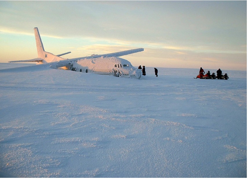

SheriffPatGarrett wrote: I remember a F-27 full of passengers, with at least fifty dead.
Nobody was killed on that F-27.
Here is a picture.
http://www.flickr.com/photos/brosha/310 ... et-663307/
You're right though about YRB. There has been no shortage of crashes there over the years.
Buddy has a point.
I don't really know a lot about IFR flying but looking at the CAP plate even though there is no published MAP for the localizer approach I have a question. Wouldn't a pilot know given that the final approach fix POKAN is published as 4.0 miles from the threshold if they didn't see the runway after flying that 4 miles at minimums would they not just commence the missed? I mean if you know that you're overtop of the runway do you really need to be told to overshoot in the approach plate?
As an aside, it seems that the Jeppesen folks added the missed approach point on their plates right at the threshold perhaps based on this rationale?

The MAP for the LOC only is shown on the plate, D0.2.
another_try
Posts: 25
raven54 wrote:The MAP for the LOC only is shown on the plate, D0.2.
No, it is not.
Approaches do not work that way -- you do not infer things like MAPs based on other data on the charts.
