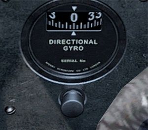

Hey be nice.. I have got a bit of time in one of those old girls...in and out of Laronge, when it was a dirt strip, circa 1969-70. That log book is long gone..but I recall it was reddish on the outside, reg maube CSO, but I could be mixing that up.
My next renewal was much less enjoyable. I had to use a hood with an old Norcanair Aztec that had a very old panel with a "hockey puck" directional gyro and fixed card ADF's.
I have always hated hockey puck DG's...sorry for the thread drift. A bit of a walk down memory lane
