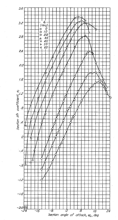

I find it amusing that you provide this picture to support your argument: download/file.php?id=7079
And you also stated that the critical angle of attack changed! But then when I showed my picture from my textbook (showing the same type of Cl line movement as in your picture you posted), you dismissed it as being wrong and proceeded to draw two Cl graphs with the EXACT same line for flaps up and flaps down. Do you see your contradiction?! Compare your graphs that you drew to this picture you attached: download/file.php?id=7079
Why are they different?! I'll help you out... one of them is wrong!

dr.aero wrote:Photofly...
There's no contradiction. The graphs are different, and they're both correct.
The graphs are different because the x-axis variables are different in each case.
The scan from the NACA report has section angle of attack on the x-axis variable.
My sketch graph has the "angle between the free stream flow and the instantaneous zero-lift line" as the x-axis variable.
It's axiomatic that any graph of Cl vs. "angle between the free stream flow and the instantaneous zero-lift line" must pass through the origin. I don't think you'd disagree.
If you change the x-axis quantity on my sketch to "section angle of attack" then the lines for the wing with the aileron up and down will slide apart and it will match the NACA graph, in substance.
If instead you redraw the the NACA data so that the x-axis is "angle between the free stream flow and the instantaneous zero-lift line" then all the lines on the NACA graph will slide sideways and pass through the origin, just as I sketched.
There's a difference in the height of the different curves of the NACA graph; the NACA curves are for a flap that descends up to 60 degrees. One of the effects of increasing the camber of a section by lowering the flap is to increase the peak value of Cl. My sketch curve was for an aileron, which descends only 10 degrees. If you look at the NACA graph for the flap extended 10 degrees you'll see the peak value of Cl hasn't change very much. I took a liberty in not showing this difference in my sketch, because it's not significant, although we discussed it.
I don't recall dismissing the picture from your textbook as wrong. I recall saying it was a valid explanation. I also recall saying that it wasn't the only valid explanation.

The problem comes when you use your different "language" to explain a picture off the internet - such as the one you attached with the different flap positions.
I didn't explain the NACA graph in different language. I think you misunderstood the point I was illustrating by posting that graph. I'm happy to have another go at making the point, although I think it's a point that you and I both accept as true, at this point. I was still, at that time, trying to work out what your objections were.
dr.aero
Posts: 272
Joined: Sat Apr 30, 2011 3:08 pm
Re: Angle of attack in a climbing turn
Post by dr.aero »
Photofly...
They're different? So in one of them the origin isn't actually at zero on the x-axis? :roll: Geez! I'm done with this crap.
Here's a reference to show you're wrong to do that: http://en.wikipedia.org/wiki/Origin_(mathematics)
Quote from that wikipedia reference: "The coordinates of the origin are always all zero, for example (0,0) in two dimensions and (0,0,0) in three."
But I'll be waiting for you to come back and tell me that you're not wrong, you're just doing it differently! :rolleyes:
If you adjust the x-axis variable of either graph to match the other, the lines will coincide, and the graphs will no longer be different.
Whoever taught you math has failed you horribly.
Let me see if I can be clearer, then.
The physical variable that's plotted on the grap, as the x-axis variable, for the NACA graph, is not the same variable along the x-axis in my sketch graph.
My graph sketches Cl (y-axis) vs. "angle between the free stream flow and the instantaneous zero-lift line" (x-axis)
The NACA graph plots Cl (y-axis) vs. section angle of attack (x-axis)
The variable along the x-axis is different. Section angle of attack is not the same as "angle between the free stream flow and the instantaneous zero lift line". That's why the NACA graph doesn't match mine.
The difference betwen "angle between the free stream flow and the instantaneous zero-lift line" and "section angle of attack" is a fixed quantity as long as the airfoil section remains unchanged. It varies according to changes in the airfoil, such as a by lowering a flap or aileron. It's therefore clear how to redraw the data from one graph in a manner that's consistent with the other. If you do that the graphs will be sustantively the same.
Can I politely suggest that you start making an attempt to understand what I'm saying, rather than making assumptions about my education?
Just answer the question - does the origin in both of your graph have an x and y value equal to zero?
Both my graph... that's a singular and a plural in the same sentence.
The origin of my sketch graph has a Cl value of zero, when the angle between the free stream flow and the instantaneous zero-lift direction is zero. It passes through the origin.
I define the instantaneous zero-lift direction of an airfoil section, as, in the configuration as it is at that moment, to be the angle of the free stream flow that generates no lift, or, equivalently, that direction of free stream flow for which the coefficient of lift is zero.
It's therefore axiomatic that a graph of Cl vs the angle between the free stream flow and the instantaneous zero-lift direction passes through the origin. It cannot be any other way.
It's true for a wing with an aileron up, and it's true for a wing with an aileron down. All graphs of Cl vs "the angle between the free stream flow and the instantaneous zero-lift direction" pass through the origin. A curious feature of aerodynamics is that they all have very closely the same gradient - about 0.1 units of Cl for each degree.
You can see as clearly as I can where the (0,0) point on the NACA graph is.
