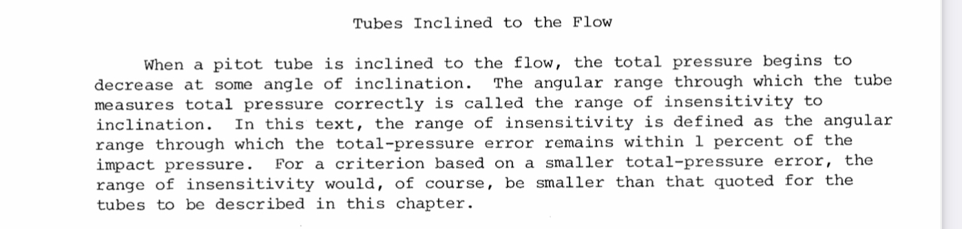

If you want to see the effect of a side slip angle on the static pressure, look for sudden altitude fluctuations on the altimeter and indications of rapid climbs/descents on the VSI as you slip. If you don’t see any, the pressure in the static line isn’t affected.
I think this (“Gracey”) is the standard place to start for anyone interested in errors in pressure measurements in flight. Chapter 4 looks relevant, particularly:
https://ntrs.nasa.gov/api/citations/198 ... hment=true
Here’s a bit to whet your appetite…
If you wonder why your pitot tube has a bullet shaped nose, here’s the answer: it’s very insensitive to angle errors (see figure 4.7) - essentially zero error in sideslips up to 20 degrees, which is more than you’re likely to obtain.
