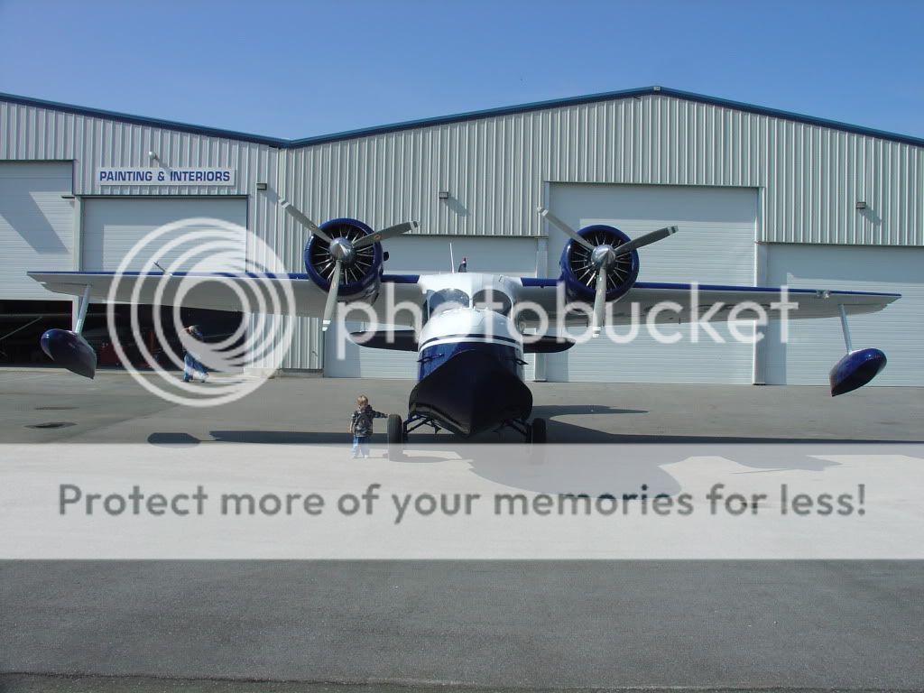

That's a great picture istp....
Thanks for posting it.
Any more recent shots of those beautiful gooses? The newish pasco scheme looks fantastic on them!

Rowdy wrote:Any more recent shots of those beautiful gooses? The newish pasco scheme looks fantastic on them!
Before logos were applied.
