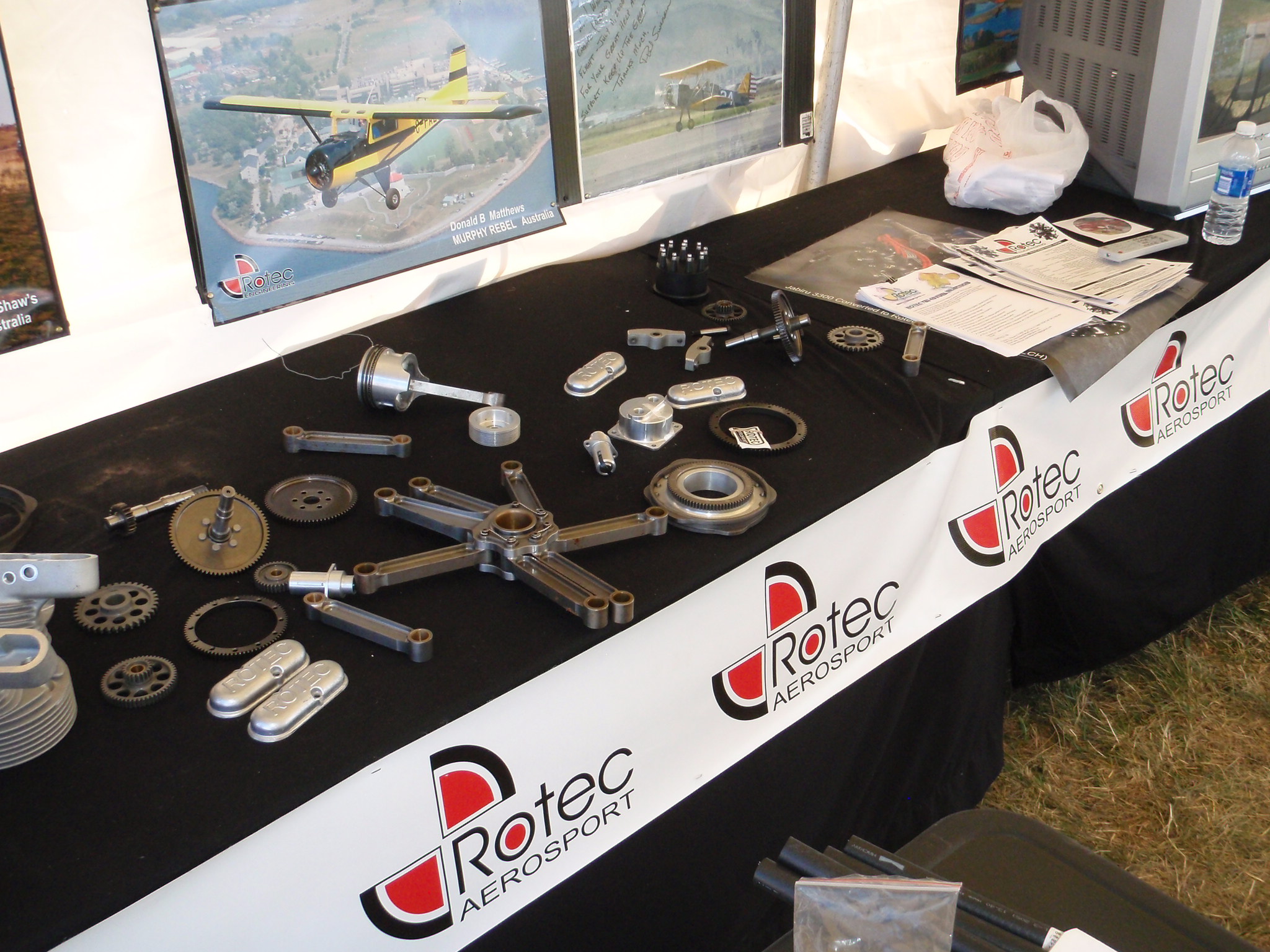

Here some pictures of his parts table at Osh a couple days after they got soaked by the rain that came through and wind that nearly blew the tent away.
Check out the client projects page. There's a guy putting the 7 cylinder units into motorcycle choppers.
http://www.rotecengines.com/ProjectTable.html
