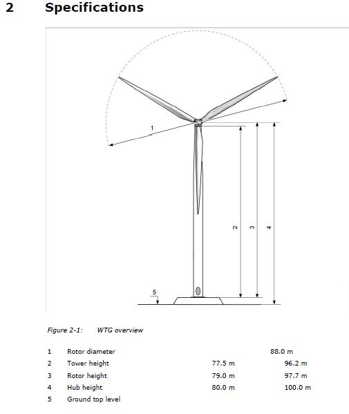

Troubleshot wrote: -500+ feet tall - FALSE - unless you are privy to a new technology I am un aware of, 500 feet would be about 200 feet taller than anything on the market to date. The tallest wind turbines will be commonly be off shore. The tallest turbine I have seen is 328 feet (100m). Most common is 80-90 meters hub height.

Hi Gerry, you are correct. I was speaking in general wind industry terms where "hub height" is the common measurement. I should have been more clear. With one blade pointing straight up my towers are 122m tall (400 feet) each blade is approx, 44meters in length, make a rotor diameter of 88 meters. However, I am sure there are taller buildings around airports than a standard height wind turbine but I am not a pilot so I cannot say for sure. A couple of hotels at the end of Pearson's runways come to mind but I have no idea how tall they are. Worth noting that 100meter towers are almost always used in off shore applications.
someone posted a story where a wind turbine park was encroaching on an airport in Chatham-Kent I believe, and Transport Canada has ordered them to be removed. My "Beef" was with the context in how so posters believe these turbines are just thrown up anywhere without any studies. The site in Chatham-Kent is an interesting one seeing how Transport Canada is usually involved in the approval process. Someone F'ed up big time here.

Troubleshot wrote: With one blade pointing straight up my towers are 122m tall (400 feet) each blade is approx, 44meters in length, make a rotor diameter of 88 meters. However, I am sure there are taller buildings around airports than a standard height wind turbine but I am not a pilot so I cannot say for sure. A couple of hotels at the end of Pearson's runways come to mind but I have no idea how tall they are.
A quick look at the Toronto VTA reveals that all the nearby obstacles are much lower than that: the following are heights above ground level for all the (marked) obstructions within 3nm of the centre of Pearson: 125, 150, 110, 148, 130, 148, 149, 94, 115, 136
At approximately 4nm distance there are two higher obstructions, at 401 and 417 feet agl.
A 122m obstruction could be one of your turbines, or it could be a 35-40 storey building. They're both about the same kind of hazard to aviation. There are no 35 storey buildings that close to Pearson airport.
