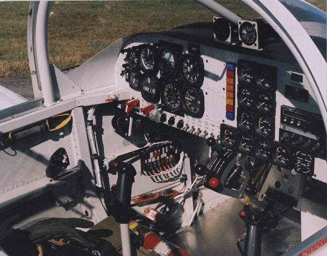

I was up in a Robin DR400-180 last weekend. Dual sticks and dual throttles, meant to have the stick in the right hand, throttle in the left.
http://www.airport-data.com/aircraft/ph ... 7980L.html
