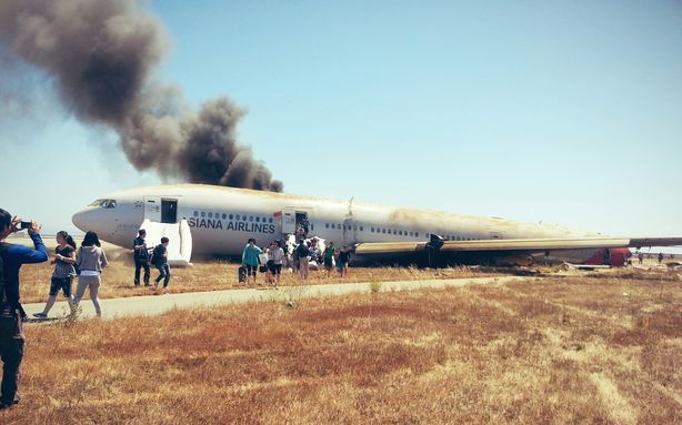

While icing could be possible - I doubt it. The fuel heaters were re-designed to prevent clogging. I suppose an old one could have been installed, however its probably pretty remote that it is the cause.
As for the fire, You can see clearly that the fire starts outside the fuse on the right side, then other pics show a burn at the approximate floor level right next to the #2 engine - which was resting against the fuse. The fire started on the engine and burned through the lower right side of the fuse. Once the fire got in the cabin that was it. Passengers even said fire and smoke started later - after most were out. This would also account for the fact that the back half of the cabin is not fire damaged.
fire buns next to #2 engine
Fire on right side outside of cabin. no holes in top of plane yet.
