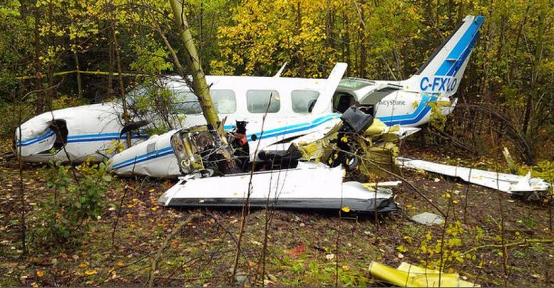

As it so happens it seems like the airplane was filled with jet A instead of Avgas. Which makes it fueled and pilot error.

Something doesn't add up here. CBC is now reporting that they first reported electrical problems, and that they didn't require assistance; shortly after, they disappeared from radar and lost radio communication, but it isn't specified whether that's because they lost electrical power or because they descended too low. There's also a comment about the wreckage not burning, which makes me wonder about the amount of fuel on board, of any kind. The person who's saying it might have been the wrong fuel type is the company president, and clearly he would stand to gain from putting the blame on the fueller.

It's surprising they managed to start up, run up, taxi, take off, and fly for 3 minutes before the lines ran out of AvGas considering it is Lighter than JetA. Plus the wing broke off and all lines attached to the engine were severed yet no fire!!! I know JetA isn't as explosive as AvGas but lets hope TC finds fuel in the tanks.

Welp, that makes the 3rd Keystone Navajo I have personally seen balled up into a bunch of wire and shattered metal/glass.Skud Run wrote:It's surprising they managed to start up, run up, taxi, take off, and fly for 3 minutes before the lines ran out of AvGas considering it is Lighter than JetA. Plus the wing broke off and all lines attached to the engine were severed yet no fire!!! I know JetA isn't as explosive as AvGas but lets hope TC finds fuel in the tanks.
Nice job by the crew putting that one down. That's for sure!
