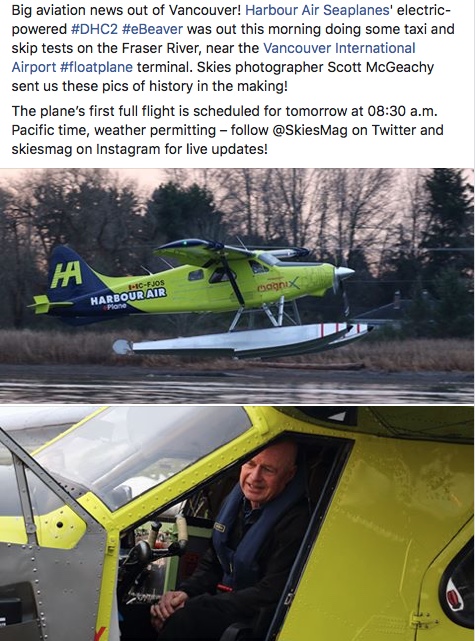

Re: Harbour Air switching to battery powered planes
- Untitled 7.05.40 PM.jpeg (154.57 KiB) Viewed 3224 times
Will fix airplanes for food.
So they essentially made a Turbo Beaver, cool. As in, same horsepower as the -34 powered bird.
I wonder what the range/endurance of a Beaver with what likely amounts to 1,500 pounds of batteries tucked in her belly amounts to...

So far advertised as good for a 30 minute sight seeing flight with reserves. I get electricity is cheaper than avgas, but I gotta figure that sight seeing flight won't be cheap. Also I don't remember what the charge time was after such a flight. Wonder how many they can actually accomplish in a day? At any rate good proof of concept at least.

The prop looks interesting. I wonder if it is has an electric motor for pitch change like MT, looks like hartzel blades.

Is just the e-beaver that colour?
