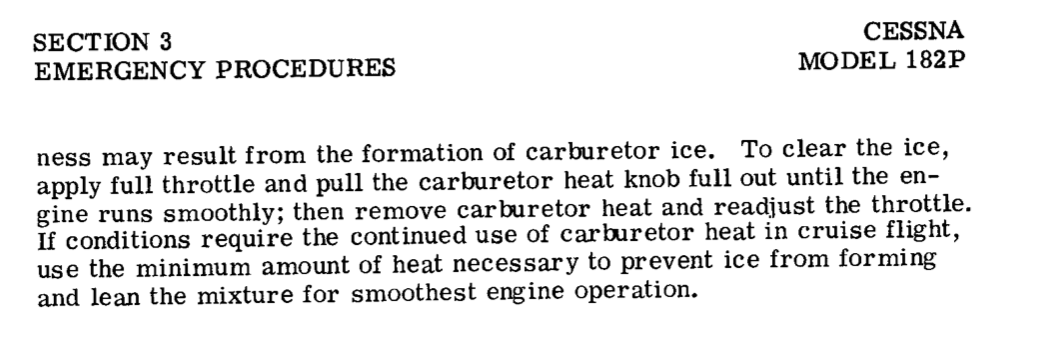

Re: 182 down by Smithers
pelmet wrote: Wed Jun 17, 2020 10:01 am The C182 POH states that after using carb heat to remove carb ice, partial carb heat can be used with the minimum amount of heat required to prevent it from forming. It states that 'trial and error' can be used. There is no definition of what error would be. That seems to go against conventional wisdom of not using partial heat without a carb temp guage.
Here's the entry:
Screen Shot 2020-06-17 at 10.23.59 PM.png (139.53 KiB) Viewed 3239 times
PilotDAR
Posts: 4113
Post by PilotDAR »
even if working and used perfectly, will not provide sufficient heat to remove ice in conditions of heavy carb icing. I think the logic is that there is more moisture in each intake stroke of a 550 than in a 470 because the intake volume is greater, while the heat produced is not.
This has been my experience in all carburetted Continentals. So, which this less than ideal characteristic, I optimize the wording of the Flight Manual which Photofly quotes; I "readjust the throttle" earlier in the process. As if I really need carb heat to have the most effect, as soon as I have applied it, I'll lean (to cause maximum EGT). I'll evaluate the effect (which may include the engine stumbling as ice melts and is ingested), and as I can, I'll close the throttle as much as I can accept the lesser power, and lean more. The closed throttle reduces induction airflow, and thus reduces the amount of cold, moist air which must be warmed by the carb heat.
On one un-nerving night flight, that was not enough. I was really high, so as I descended under limited power, I gently used the primer to add a little power to the engine, and it was enough to have deicing effect, and I got power back.
Posts: 7955
PilotDAR wrote: Thu Jun 18, 2020 4:04 am
The manual says apply full throttle, not a reduction in power. Are you saying that the manual is incorrect or the manufacturers technique is not as effective as reducing power?
PilotDAR
Posts: 4113
Post by PilotDAR »
Sadly, and with reluctance, I am. Yes, usually, I'm the person stating that the flight manual should be followed. If you were flying one of the two C 185's I STC approved with a carb, you would read my flight manual supplement which states a procedure as I describe. During my testing for that approval, that procedure was the difference between pass and fail for the carb air temp rise requirement - repeatedly. Anyone flying a plane with a carb air temperature indicator can very safely experiment with this (you don't have to wait to have carb ice). No harm can be done experimenting with carb heat application and power settings, as long as peak lean is respected. Watch the CAT to see what happens... I did.
While, in my posts, I try really hard to align what I write with the flight manual procedures for the aircraft, I know, as others do here too, that there are "tricks" which are not published, which once understood, result in a better yet outcome. My only guess would be that Cessna's lawyers would rather that a flight manual say to apply full power if in doubt, than to use a technique which could result in using power inadequate to maintain level flight, if not cautious. Caesar Gonzales was the Cessna guru on this kind of stuff, and I met with him a number of times at the ASTM gasoline meetings during my Mogas research. Caesar would tell me things about his experimentation, and his operation of his C 150M on Mogas which were very informative (and not always in line with Cessna's corporate position), and from his information I built on my knowledge. Discussion with him about induction airflow and carb heat was a part of this learning for me.
That is a very counter-intuitive result, and definitely calls for some experimentation :-)
